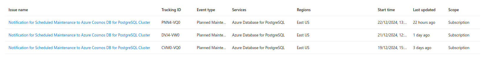

    Firstly, you will need to diagnose and confirm Azure-Side changes: Use the Azure Service Health dashboard to identify if any updates were applied to CosmosDB or the hosting infrastructure, particularly related to FIPS enforcement. - https://portal.azure.com/#blade/Microsoft_Azure_Health/AzureHealthBrowseBlade/serviceIssues
