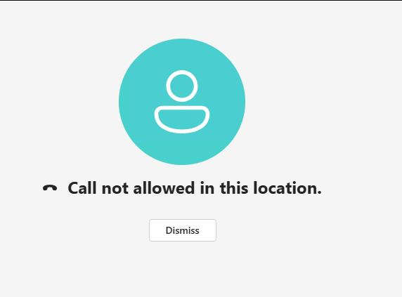

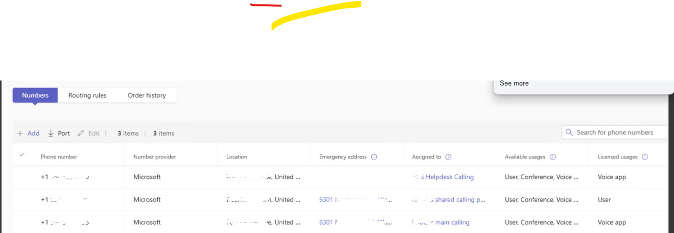

Hello,
Please i need your help on this issue about Diag: Teams PSTN.
We are unable to make outbound calls in Teams.
The user is not part of a Calling Plan, Direct Routing, or Operator Connect setup?
All the outbound calling policies are configured correctly for the user in the Teams Admin Center?
The issue occurs for all outbound calls.
I have configured a call routing policy.

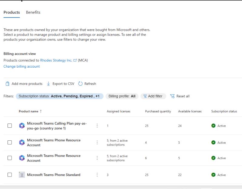

    In addition, please try the following steps to troubleshoot:
    • License restrictions: Some licenses may have specific geographical restrictions. Please confirm that your colleague's Teams phone license for international calls allows calls from the country this user is located in.
    • Location settings: Microsoft Teams may restrict calls based on the user's geographical location. Please check the location settings in the Teams admin center to make sure that there are no settings that block calls from his/her country
    • Network configuration: If your organization uses location-based routing (LBR), please make sure that her/his network in his country is configured correctly. LBR may restrict calls based on the network the user is connected to.
    • Enable international voice: In the Teams admin center, make sure that the "Enable international voice" setting is enabled for the user. This can be done by following the steps below: Sign in to the Teams admin center with your administrator account. Navigate to Users -> Manage Users. Find and select the user for whom international voice needs to be enabled. In the details page, select Voice -> Calling Plan. In the calling plan settings, find and enable the "International Voice" option.
    Licensed users can call out to numbers located in the country/region where their Microsoft 365 license is assigned to the user based on the user's location. So, we recommend you check if the destination country is in the support list.Make outbound calls to these countries/regions | Microsoft Learn
