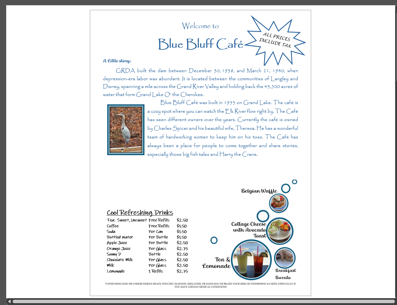

I'd noticed that when I am on the Print Preview Page, there are excess "white paper" around the margins or border of my page. May I ask how I overcome this? I have attached pictures to show the "excess" white area beyond my margins.
I've already tried fixing the margins, and I've even uninstalled and reinstalled word. So far nothing I've tried has worked I even contacted support they were unable to help me fix the issue. When I print it prints two pages very funny. It almost looks like it turned my text into an image and the image doesn't take up the whole page. I've been in page settings both on my word and in my computer. I've updated my drivers on my printer. Does anyone have additional information that would help or figure it out how to fix this issue that only started yesterday?

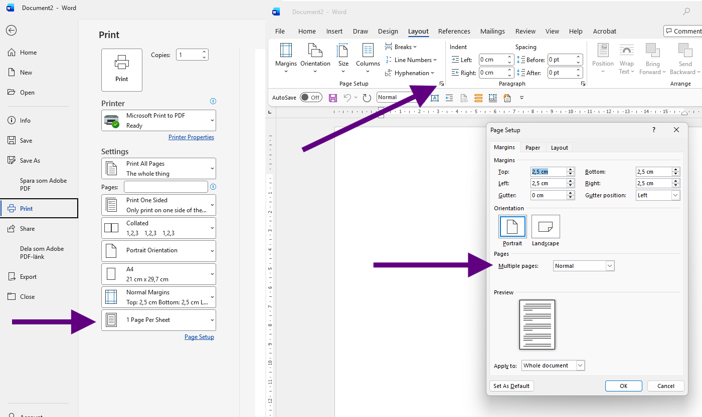

    At File > Print, make sure that "1 Page Per Sheet" is selected at the bottom.
    In the Page Setup dialog box, make sure that "Normal" is selected in the Multiple pages drop down. To display the dialog box, you can click the dialog launcher icon User's image in the Page Setup group on the Layout tab (or you can double-click the vertical ruler).
    See the screen shot below.
    If none of this fixes the issue, it might help if you uploaded some screen shots to illustrate what you see in your document.

    This sounds less like a true margin problem and more like Word’s preview/print settings getting stuck. When Word starts treating the page like a scaled object, the preview can show a big white border and the printout can come out shrunken or split oddly.
    Here are some suggestions you can try:
    If the extra white area is only in preview, turn Show White Space between Pages in Print Layout View back on, or double-click the gray gap between pages. That often fixes a suddenly “wrong-looking” page without changing the document itself.
    In File > Options > Advanced > Print, clear Scale content for A4 or 8.5" x 11" paper sizes. Also check the Print screen and make sure it is not set to a scaled or multi-page print mode.
    It is suggested that you disable any third-party Word add-ins and test again, since add-ins can interfere with print layout.
    If this only happens in one document, create a new blank file and copy the content into it. If it happens in all documents, resetting Normal.dotm is worth trying because a damaged template can break print preview across Word.
    Thank you for your patience in reading, I hope this information has been helpful to you.
