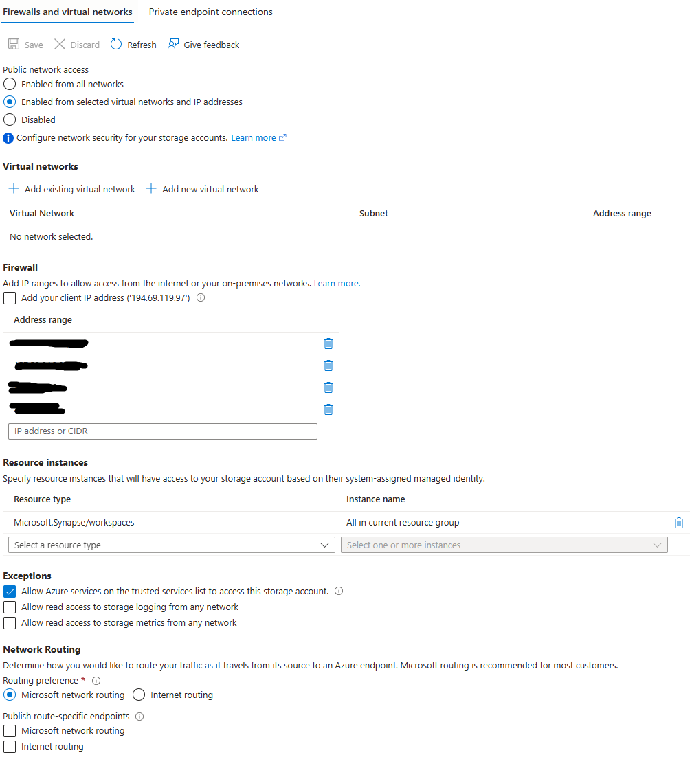

I'm trying to access ADLS Gen2 storage from PySpark notebook in my Synapse workspace. The storage account has public network access enabled from selected virtual networks and IP addresses, and my IP address is added to the firewall rules, trusted Azure services access is enabled, and Synapse workspace resources instances are added to allowlisted explicitly (see the image attached below).

Here's how the storage account networking setup looks like:

    If you’re working within a corporate network, there might be network policies or firewalls that restrict access to certain resources and if you are using a virtual network (vNet) with service endpoints for the storage account, ensure that the vNet and the APIs are properly configured to allow traffic between them. Check if any network security groups or route tables are blocking the communication.
