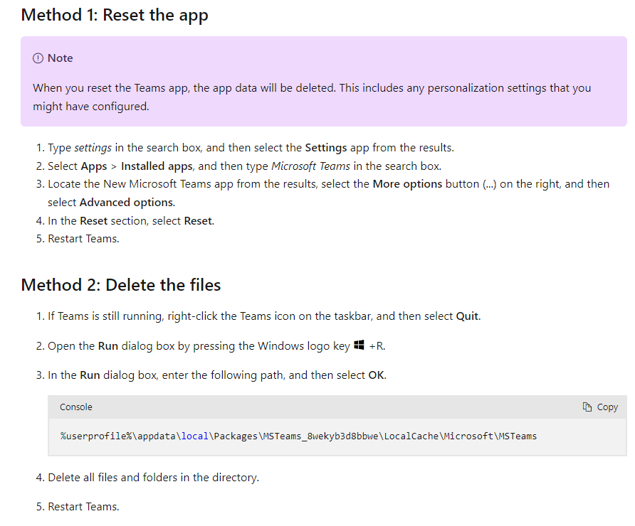

    • Troubleshoot device problems: Clear Teams cache: User's image Make sure the Teams app is the latest version. Or try using the https://teams.microsoft.com/v2/ to see if the problem persists.
