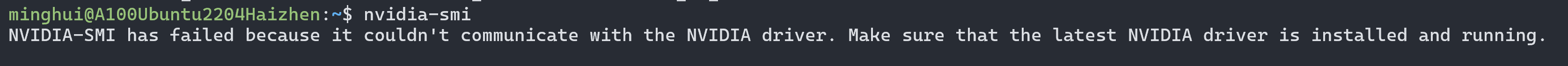

I'm using A100 on Azure, and I finally successfully installed the GPU driver, ref: https://learn.microsoft.com/en-us/answers/questions/2237112/cannot-install-gpu-driver-535-a100-80g-gpus?comment=answer-2014527&page=1#comment-1981851

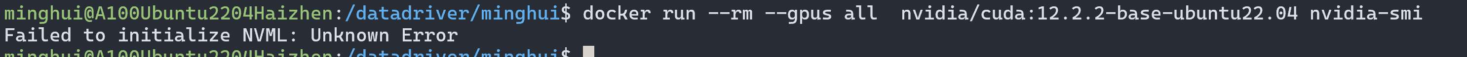

However, I cannot use my A100 when launch a Docker!
Urgent, need help.

    Problem Summary- You successfully installed the NVIDIA driver for your A100 GPU (such as version 535), but running this Docker command- docker run --rm --gpus all nvidia/cuda:12.2.0-base nvidia-smi failed with the error- Failed to initialize NVML: Unknown Error
    However, you confirmed the GPU works inside the container only when manually mapping the device --device=/dev/nvidia0:/dev/nvidia0
    This indicates that the NVIDIA driver is working, but the NVIDIA Docker runtime wasn’t properly configured.

    To resolve the issue and use the standard --gpus all flag, you need to ensure the NVIDIA Container Toolkit is properly installed and configured. First of all, confirm host GPU is recognized by running nvidia-smi on your host VM. If this fails, the GPU driver might not be installed correctly. Give a reboot to the VM as it helps if the install was recent.
    Install NVIDIA Container Toolkit. This allows Docker to communicate with your GPU
    distribution=$(. /etc/os-release;echo $ID$VERSION_ID)
    curl -fsSL https://nvidia.github.io/libnvidia-container/gpgkey | sudo gpg --dearmor -o /usr/share/keyrings/nvidia-container-toolkit-keyring.gpg
    curl -s -L https://nvidia.github.io/libnvidia-container/$distribution/libnvidia-container.list \
      | sed 's#deb https://#deb [signed-by=/usr/share/keyrings/nvidia-container-toolkit-keyring.gpg] https://#g' \
      | sudo tee /etc/apt/sources.list.d/nvidia-container-toolkit.list
    sudo apt update
    sudo apt install -y nvidia-container-toolkit
    Use the nvidia-ctk tool to configure NVIDIA as Docker's runtime
    sudo nvidia-ctk runtime configure --runtime=docker
    sudo systemctl restart docker
    Now test with the official CUDA container:
    If everything is configured correctly, you should see your A100 GPU listed in the output.
