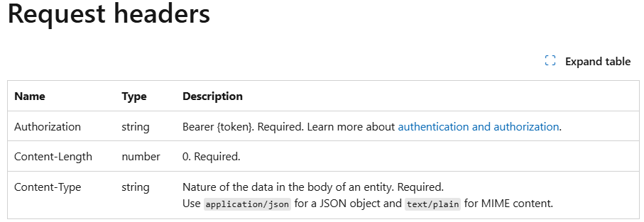

    1. According to the endpoint documentation you’re using: https://learn.microsoft.com/en-us/graph/api/user-post-messages?view=graph-rest-1.0&tabs=http#request-headers this API requires:
      • Content-Type
      • Content-Length User's image In many cases, missing or invalid headers result in 400 Bad Request rather than 500, but since your post does not mention the exact headers sent, please double‑check that Content-Type is present and correct and that your client is setting Content-Length appropriately.
    2. Try the same operation against a non‑shared (user) mailbox to isolate whether the error is specific to the shared mailbox configuration or more general service behavior, please attempt the same POST (/users/{id}/messages) with a regular user mailbox.
      • If the user mailbox succeeds while the shared mailbox fails, that points to a shared mailbox–specific issue or configuration nuance.
      • If both fail with 500, it more strongly suggests a service‑side problem requiring investigation by Microsoft Support.
