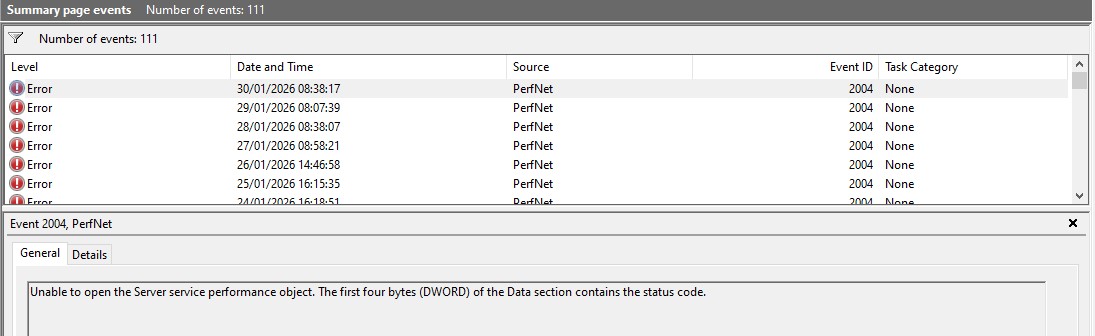

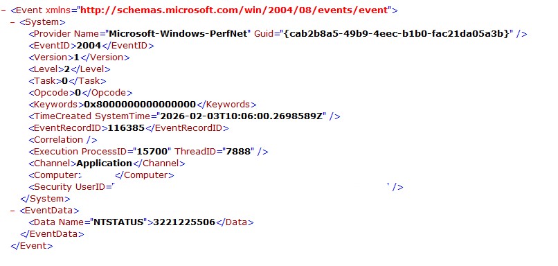

Every time when I start up the PC and login, it starts to load very slow. I checked the Event Viewer and noticed many same error daily. (see screenshot). It could be related to Event ID 2004.
Unable to open the Server service performance object. The first four bytes (DWORD) of the Data section contains the status code.

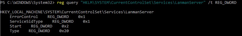

The server in service is already set to Automatically. (see screenshot). I am using Windows 10 Home Edition.

    Based on what I see here, the Lanman Server service is running well. So in this case, the cause highly comes from Performance Counter issue. Please try to follow these steps to fix it.

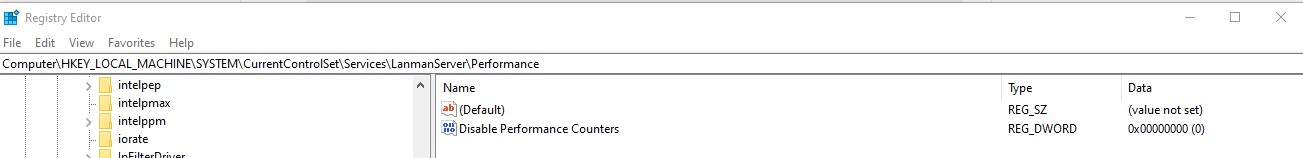

    • Type "PowerShell" in the search bar and choose "Run as administrator"
    • Type reg query "HKLM\SYSTEM\CurrentControlSet\Services\LanmanServer\Performance" /v "Disable Performance Counters" and press Enter.

      1. reg add "HKLM\SYSTEM\CurrentControlSet\Services\LanmanServer\Performance" /v "Disable Performance Counters" /t REG_DWORD /d 0 /f
