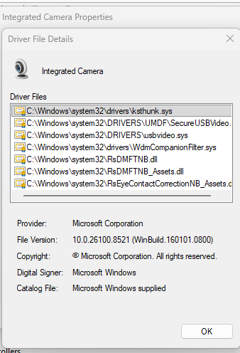

    same happening for me User's image
    Any solution ?
