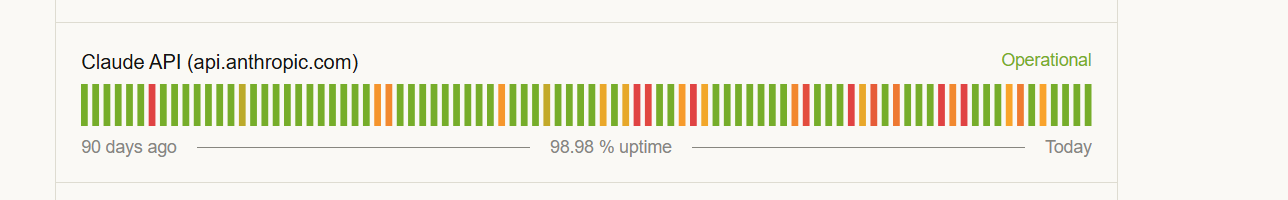

I have been having authentication issues using claude sonnet models in azure foundry - the errors are intermittent
mostly authentication errors
"{"error":{"code":"invalid_model_endpoint_authentication","message":"Failed to authenticate to backend endpoint. RequestId = req_011CZppPKJPrcnPiNtHteK2R","details":"Failed to authenticate to backend endpoint. RequestId = req_011CZppPKJPrcnPiNtHteK2R"}}"
There is nothing wrong with my api key or code because right now everything is working again
I have been reading the forums and see that every day the claude api has issues - should that affect a azure foundry deployment ?
like i said it's intermittent which leads me to believe that there are platform issues somewhere
