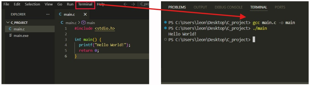

Once the required tools are installed, you can use the integrated terminal in VS Code to build and run your code. For example, in C:
gcc main.c -o main
User's image If you prefer a simpler setup with built-in build and run capabilities, you might consider using Visual Studio 2026 Community. It is a full IDE (Integrated Development Environment) that allows you to compile and run your code with minimal setup and often just a single click.
