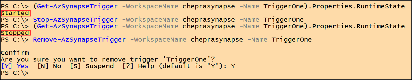

    Could you please confirm if the trigger’s runtime state is “Started”? You can get the state by (Get-AzSynapseTrigger -WorkspaceName wsname -Name triggername).Properties.RuntimeState
    If the state of trigger is “Started”, you should first stop it, then the trigger can be deleted successfully. You can stop the trigger by run: Stop-AzSynapseTrigger -WorkspaceName wsname -Name triggername.
    Note: Any changes made via SDK, PowerShell will not be synced with the Synapse workspace linked with any source control. You can see the changes in the live mode.
