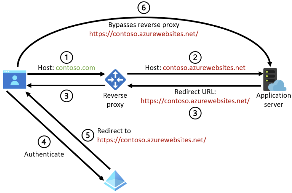

    Your observation is correct, the authentication issue is because of Incorrect redirect URLs
    • User's image
    Suggestion :

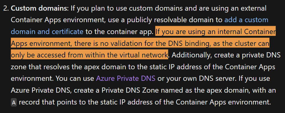

    • You should consider using a custom domain, both in AFD and Internal Container Apps
      • Let's consider this as "app.contoso.com"
    • This way, the host name between Client to AFD and AFD to the ILB will remain the same.
    From Container Apps side,
    From AFD side,
    From Entra side,
    • Now, the call back URL can use the hostname "app.contoso.com" without any issue.
