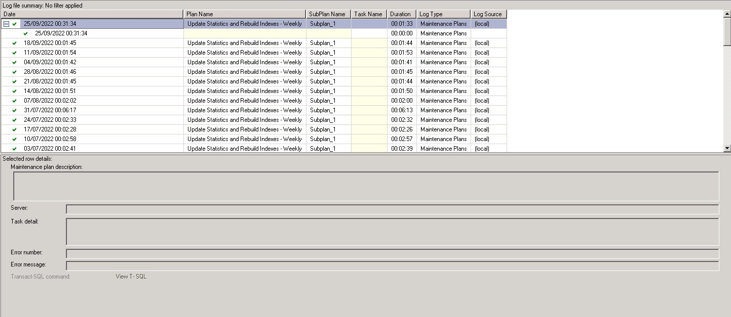

  1. Robbie Varn 351 Reputation points
    2022-09-30T15:00:08.05+00:00
    Can you review the maintenance plan history (right-click on the maintenance plan in Object Explorer and View History).
    From there you should be able to see what task failed and the actual error. Can you then paste that in here for review?
  2. ShamVMH 21 Reputation points
    2022-09-30T15:16:09.933+00:00
    It doesn't tell anything, see screenshots below:
