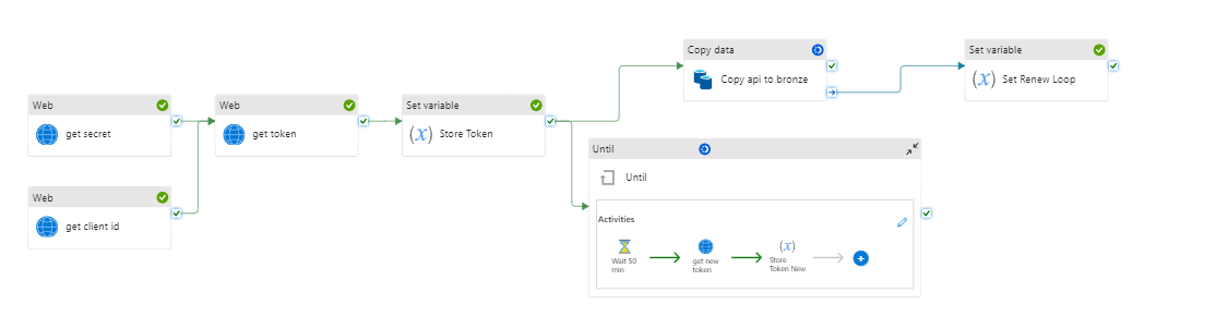

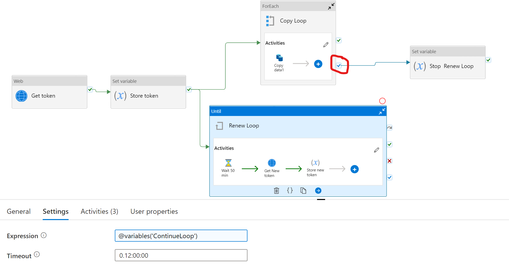

    Below I have a proposal diagram.
    Diagram

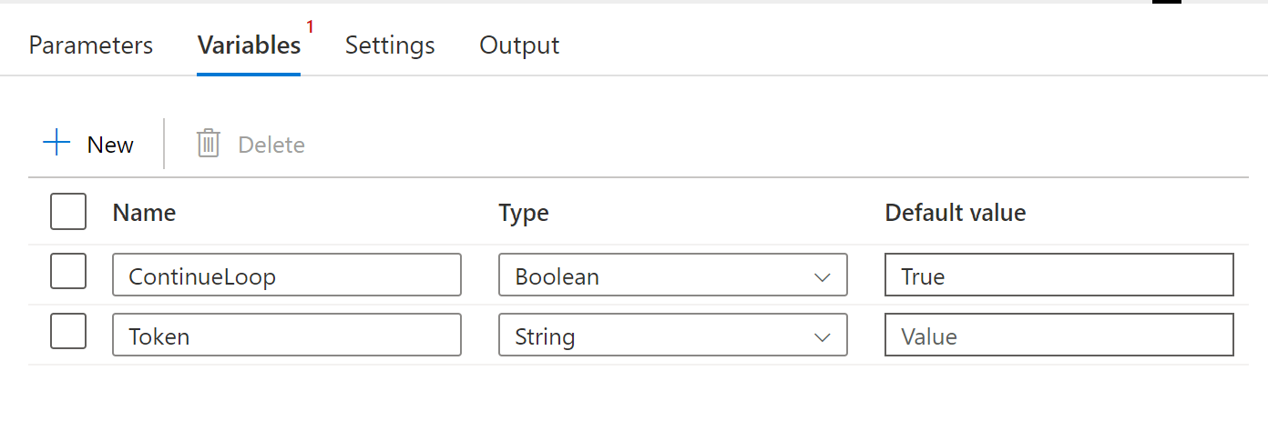

    We can use an Until loop to wait 50 minutes, then fetch and store token (exact same way you already have). It will repeat until something tells it to stop. We need something for this. Create a boolean type variable, with default value of true.
    variables
    This will be used to tell the until loop whether to repeat or stop. See diagram for implemtation in untl activity.

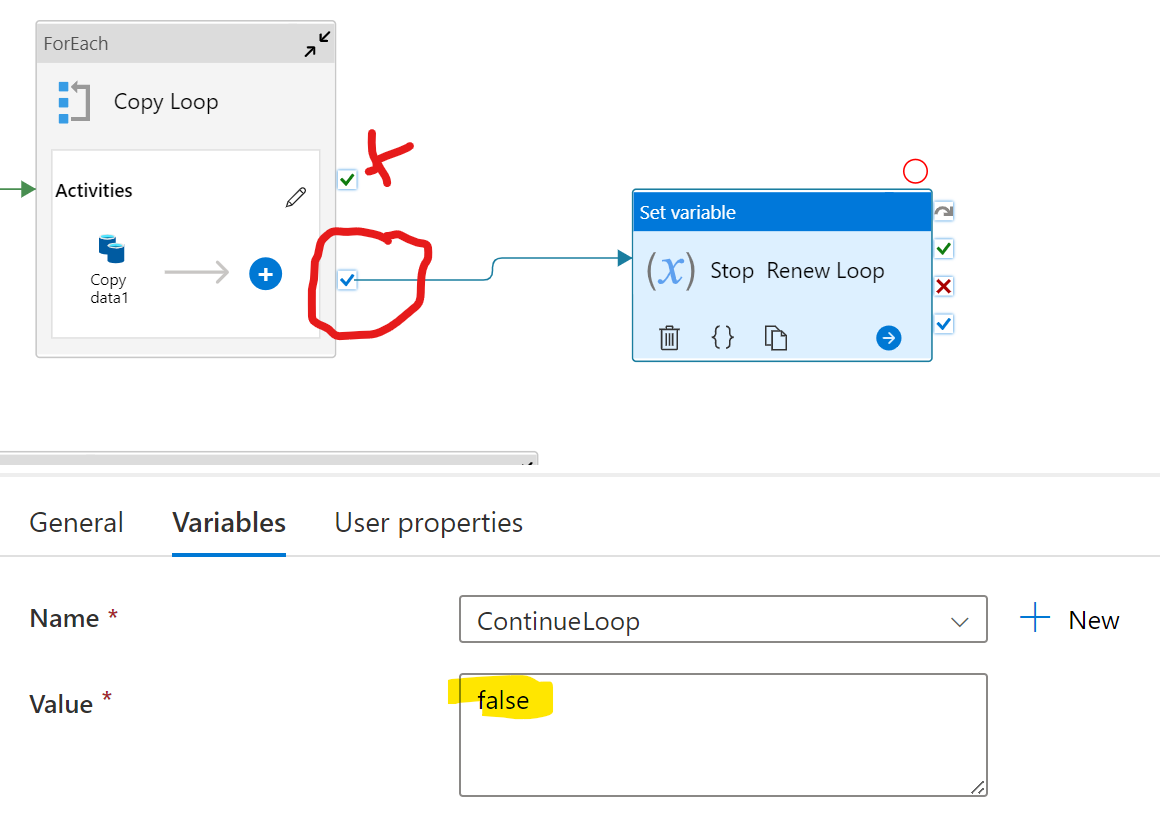

    We need to change the value to false after the ForEach loop ends, no matter success or failure. Use a Completion dependency to link the ForEach to a Set Variable. The Set Variable sets to false the boolean variable.

    Just had some issues following this solution:
    1. Boolean values are specified in lower case (true not True)
    2. The until loop executes once, and then checks the expression defined in the until activity. It will keep running the child activities until that expression evaluates as true, and then stops. So that's the opposite logic sense as to shown in the images above. The continueloop variable should really be named stoploop with a default value of false, and the last activity will be to set the stoploop variable to true
    Took me a while to figure out why my until loop was only running once, so thought I would share in case anyone else comes across this scenario.
