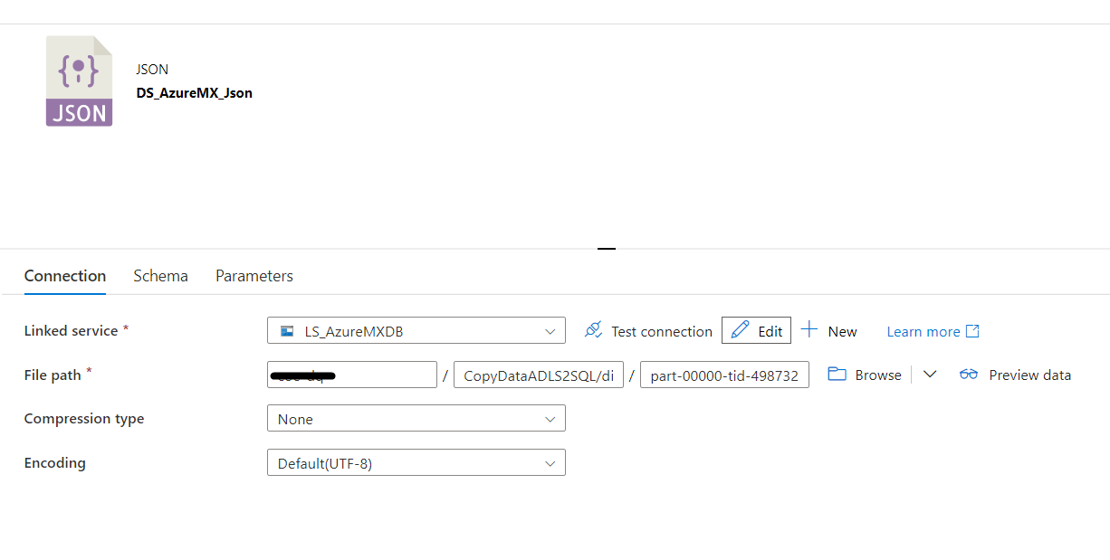

I have task to copy JSON data from ADLS to SQL Database using Rest API and in my scenario I am using Logic App which is pre configured with the database details.

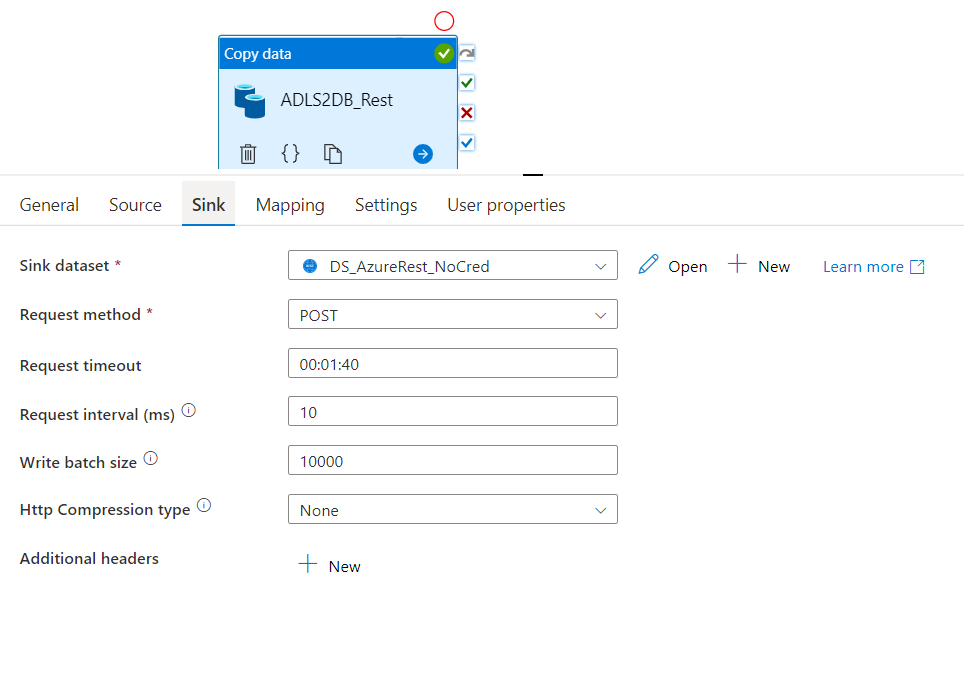

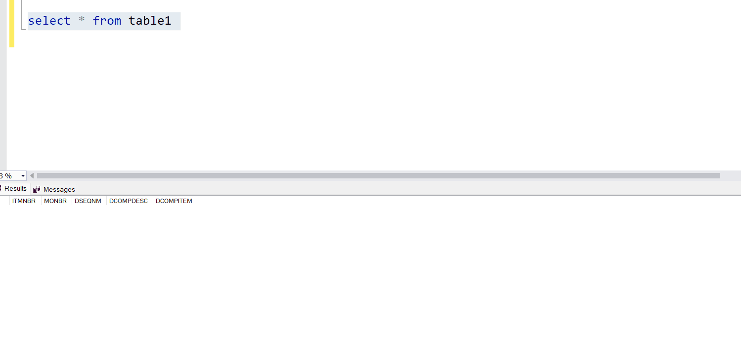

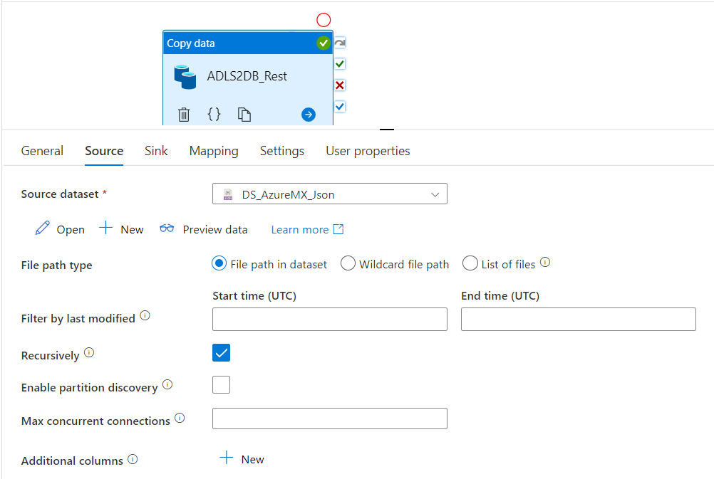

I have tried using CopyData Activity in ADF to achieve this but when I debug, the activity is getting succeeded and the data is not getting copied, instead it is showing as 0bytes transferred.
Not sure, how to achieve the task.

    1. Logic app URL is not a REST API url , when you see the logic app designer, it says, HTTP Post URL which means we can't use REST API connector to call logic app . It should be an HTTP connector. Additionally, copy activity sink doesn't accept HTTP connector . Therefore, you need to call the logic app via Web activity where we can provide the logic app HTTP URL directly.
