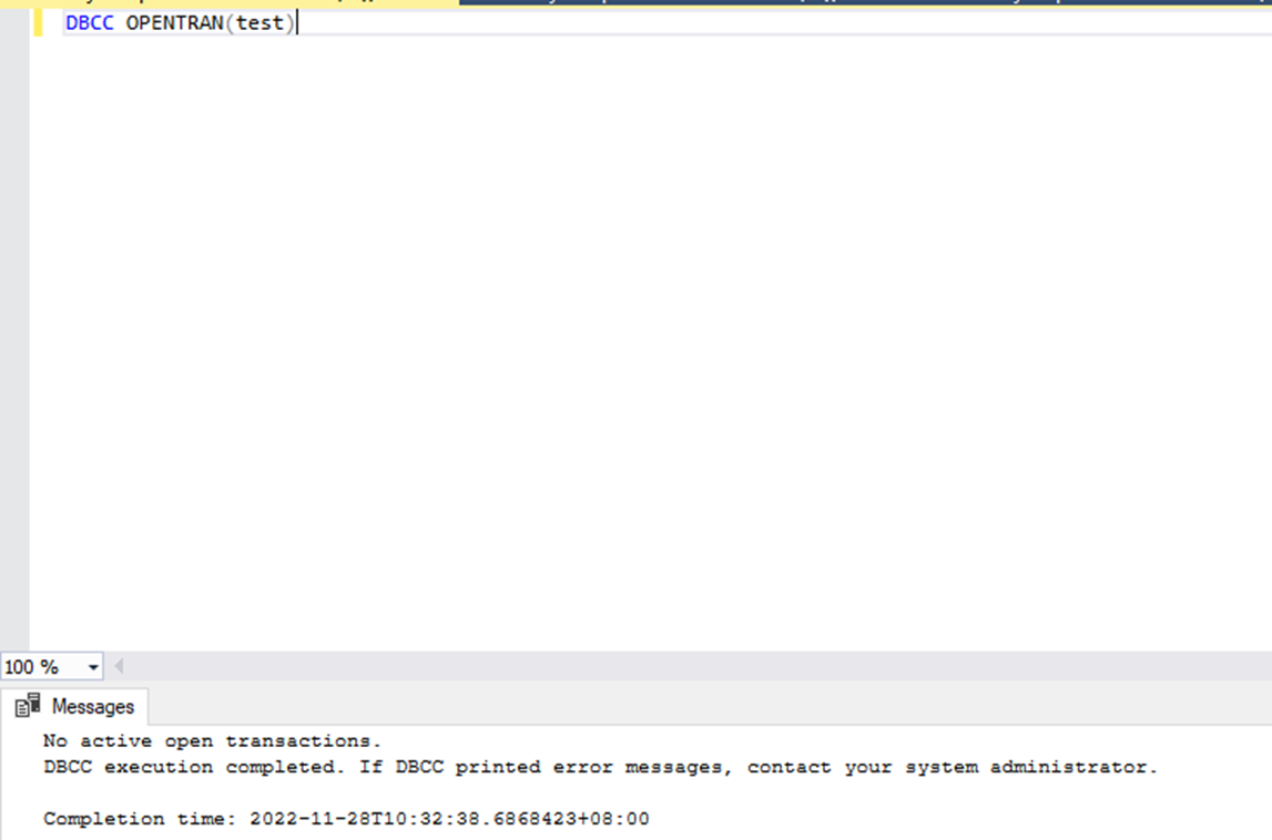

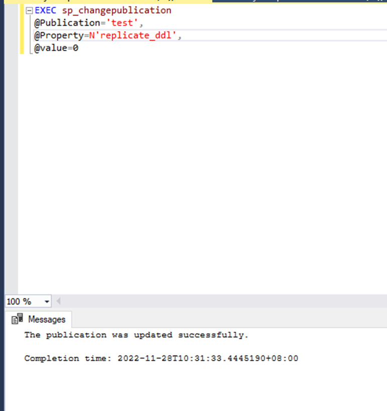

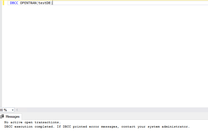

  1. PandaPan-MSFT 1,931 Reputation points
    2022-11-28T02:35:01.84+00:00
    Hi @Craig Garland ,
    I tested on my own. It works fine to me:
  2. Craig Garland 336 Reputation points
    2022-11-29T01:40:33.357+00:00
    Hi Panda,
    I will review doing this on the weekend.
    What were the OPENTRAN result before running this command?

    Also, it is suggested to change Replicate Schema Changes to False (Under subscription options). This should stop the problem reoccurring. Have not confirm this yet as it's only been a few days since the fix.
    Note setting Replicate Schema Changes to false is the same as running.
    EXEC sp_changepublication
    @Publication=’PublicationNameHere’,
    @Property=N’replicate_ddl’,
    @value=0
