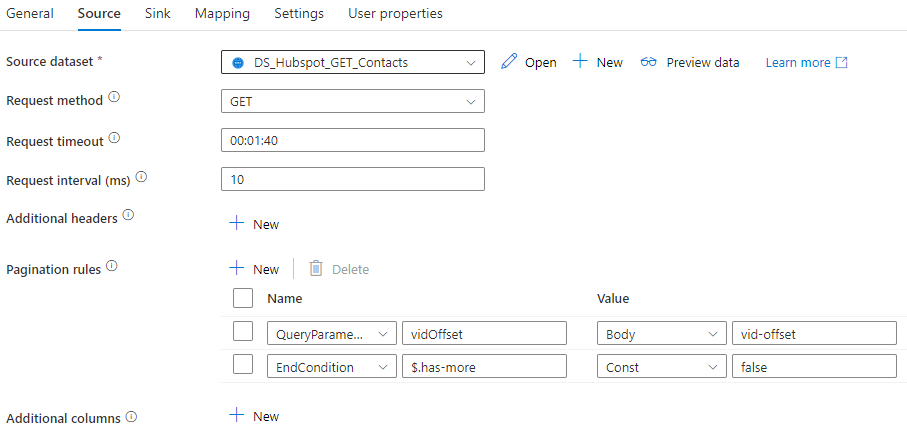

I am trying to pull data from this Hubspot endpoint. I am using this MS guide.
I want to pull all records of data from the endpoint to an Azure SQL Database table through an ADF pipeline with a copy activity. I want to use the pagination support inside the connector instead of a loop, unless that is the only option. As authentication I use a bearer token in the header. For testing purposes "hapikey=demo" can be added.
What I need:
  • Every next call after the first needs to have the parameter "&vidOffset=" set to the value provided in the body response under "$.vid-offset".
  • I need the pagination to run till "$.has-more" is set to false in the body response. In my pipeline I temporary used a max of 5 requests.
This is my copy activity:
These is my REST connector settings:
This is the error I get:
Some help would mean much to me!

    Hmm this is tricky... everything looks correct...
    The message indicates a literal {offset} was sent instead of the value. Maybe we are not hitting the property path?
    Do we need to add $. in the value to make $.vid-offest ... no that made duplicate...
    Can we try changing "QueryParameters" to "AbsoluteUrl" , but keeping everything else the same? I think this will fix it.

    I've found the solution to my problem.
    With the dataset, I left out the variable call of {offset}. This variable did only work when using range settings in the QueryParameters pagination.
    With the source settings I listed my endpoint parameter and the value I wanted to parse. The pagination rule adds the given queryparameter to the url.
