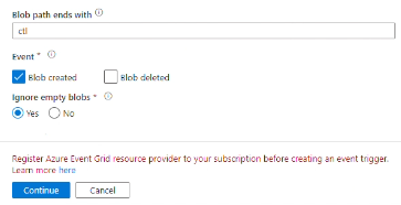

Hello everyone,

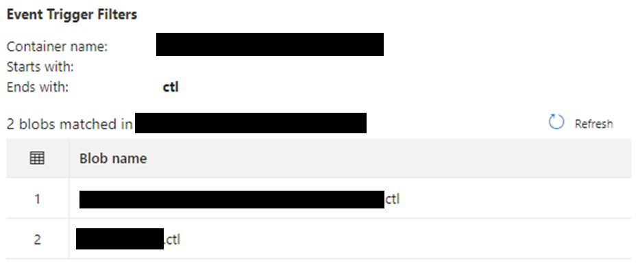

I am trying to set a storage event trigger that runs when a blob ending in "ctl" is created in a particular storage container.
When setting up this trigger, it already pattern matches with two of the blobs already created. I did that intentionally for testing if it was matching.

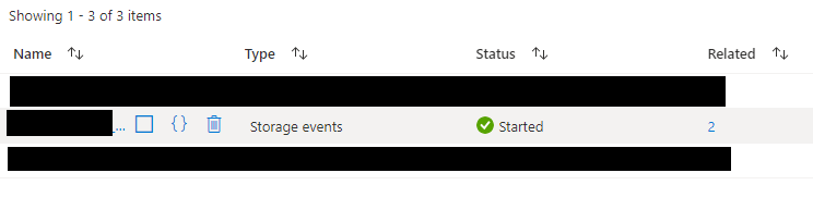

I have also proceeded to activate the trigger
but it never has run, after multiple times

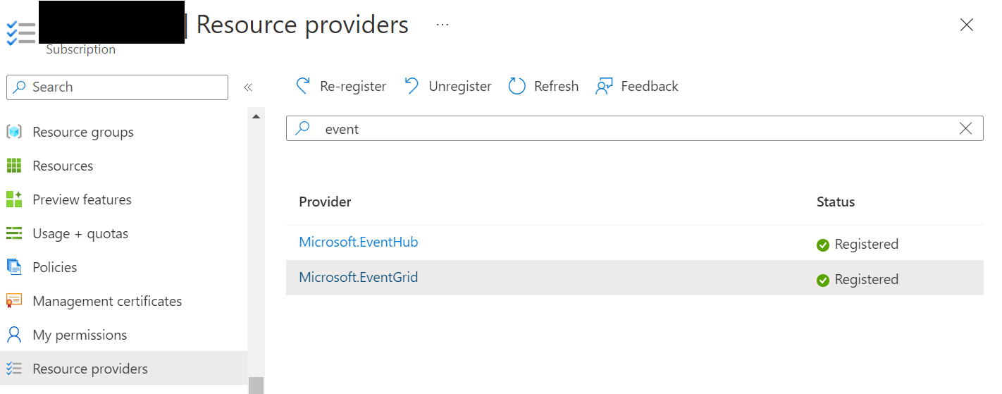

After asking for someone else in my team to try to set it up. The person faced an error when resetting the trigger. It was relative to the event grid service that should be set up with it for its execution.
Unfortunately, event after setting up the event grid service, the same problem persists.

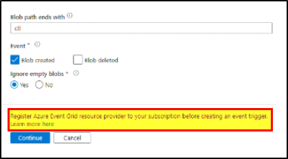

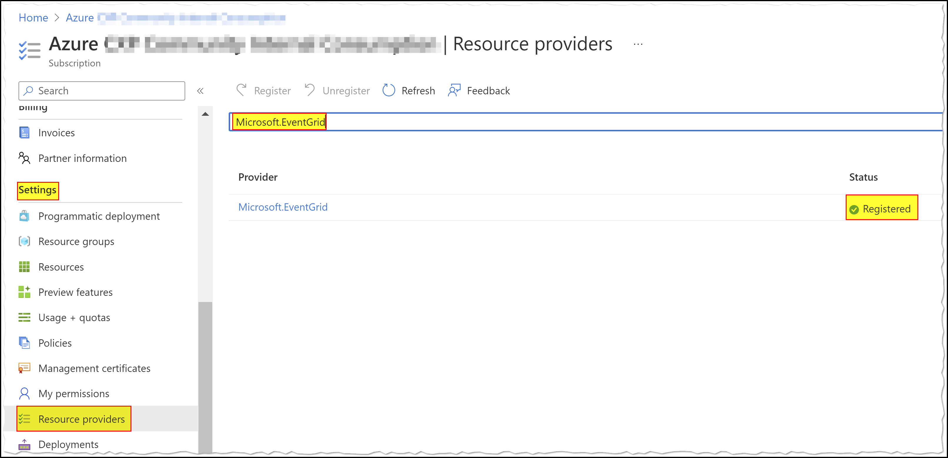

    As per the error message it looks like Event Grid resource provided in your subscription is not yet registered.
    Make you have enabled Event Grid resource provided in your subscription before using the event triggers.
    For more details, refer to Enable Event Grid resource provider.
    Hope this will help. Please let us know if any further queries.
