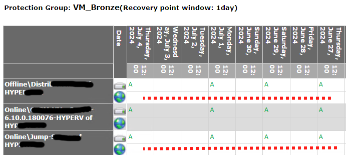

We are looking for customized backup reports on MABS server.
We have setup backup server (MABS) on onprem and backup is happening on Disk and Azure RSV vault successfully. but thing is that on azure backup sever we can see only 4 reports template like "Status" Report , "Disk utilization" reports , etc. only. these are High level reporting templates provided in MABS reporting but we are looking for Low level detailed reporting for compliance and audit requirement.
Please can you let us know if customize or Adhoc reporting is available for Azure Backup server (MABS) Reporting console. and how to achieve adhoc reporting in MABS server?
