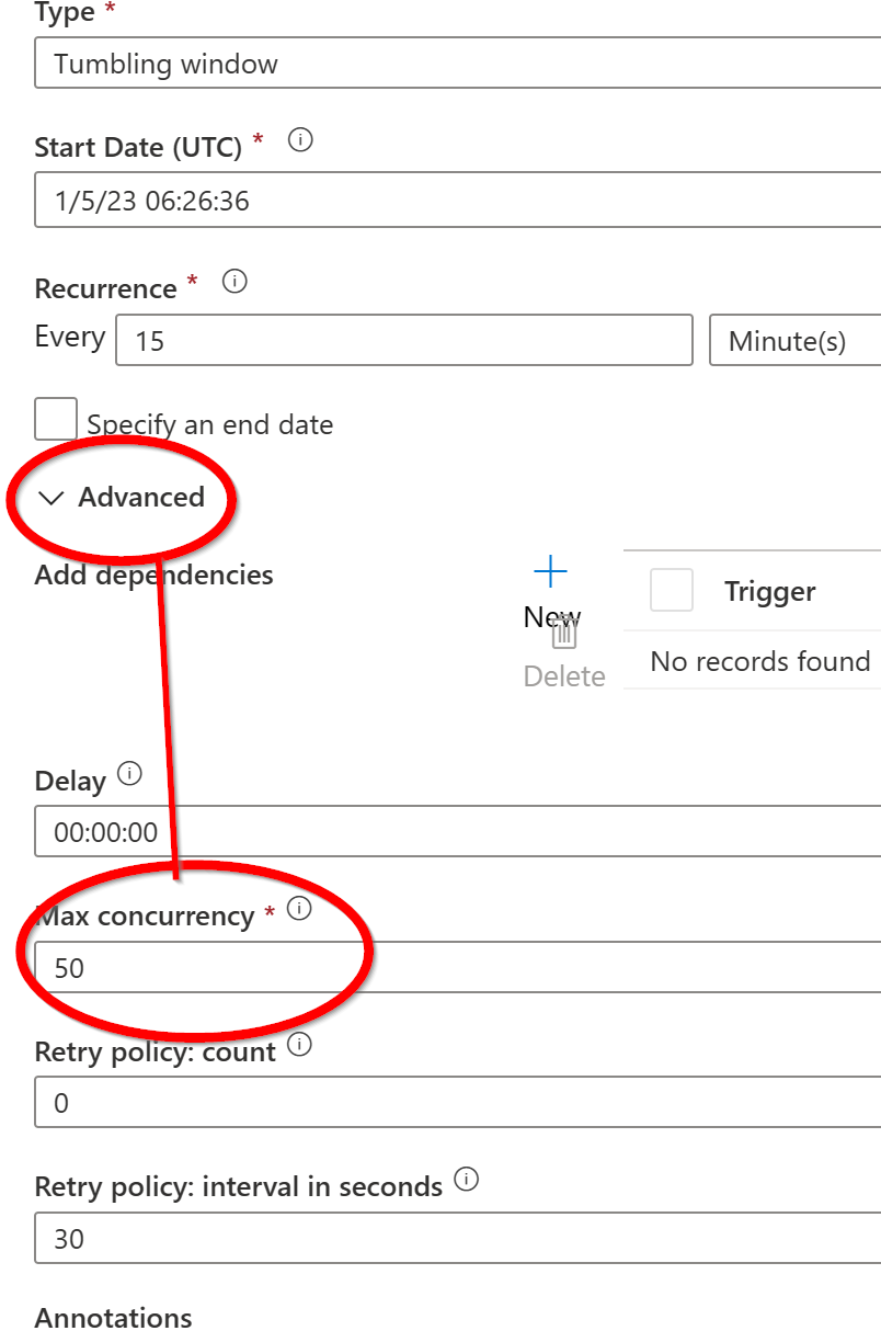

    There are two places where concurrency is set. You already found the pipeline concurrency, but there is also a tumbling window trigger concurrency.
    trigger concurrency
    Therevis another thing to try, I assume your trigger currently does not have any dependencies. If you set up self-dependency, that is make the trigger depend upon the success of the previous run, then the trigger has no choice but to wait for completion before adding to the queue.

    Thanks @MartinJaffer-MSFT , previously we used the self-dependency in the trigger but that created issues when re-triggering a failed trigger. We were not able to consistently re-trigger a failed trigger and the only work around was to remove the self-dependency and manually re-triggering for the failed windows. ADF team had mentioned there was a bug which prevented re-triggering with self-dependency when trigger max concurrency is set to 1 and they had no ETA for the fix. Hence, we moved away from trigger self-dependency, but we have this queuing issue now.
