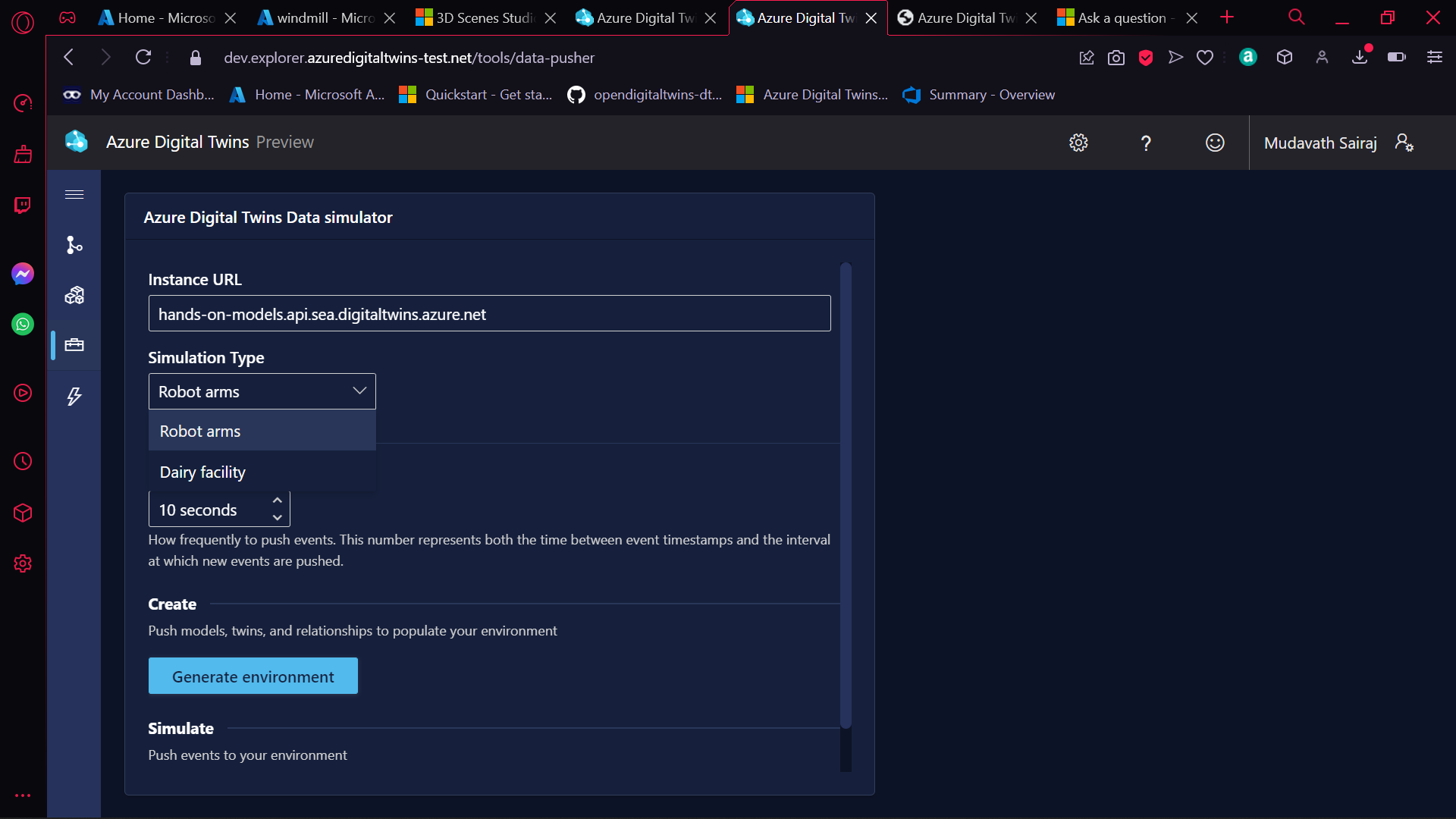

After opening the azure digital twin data simulator, In the simulator type dropdown, only 2 demo models are available, how can I add new models.

    You are looking at the data simulator.
    Tes, there are two kinds of simulatons.

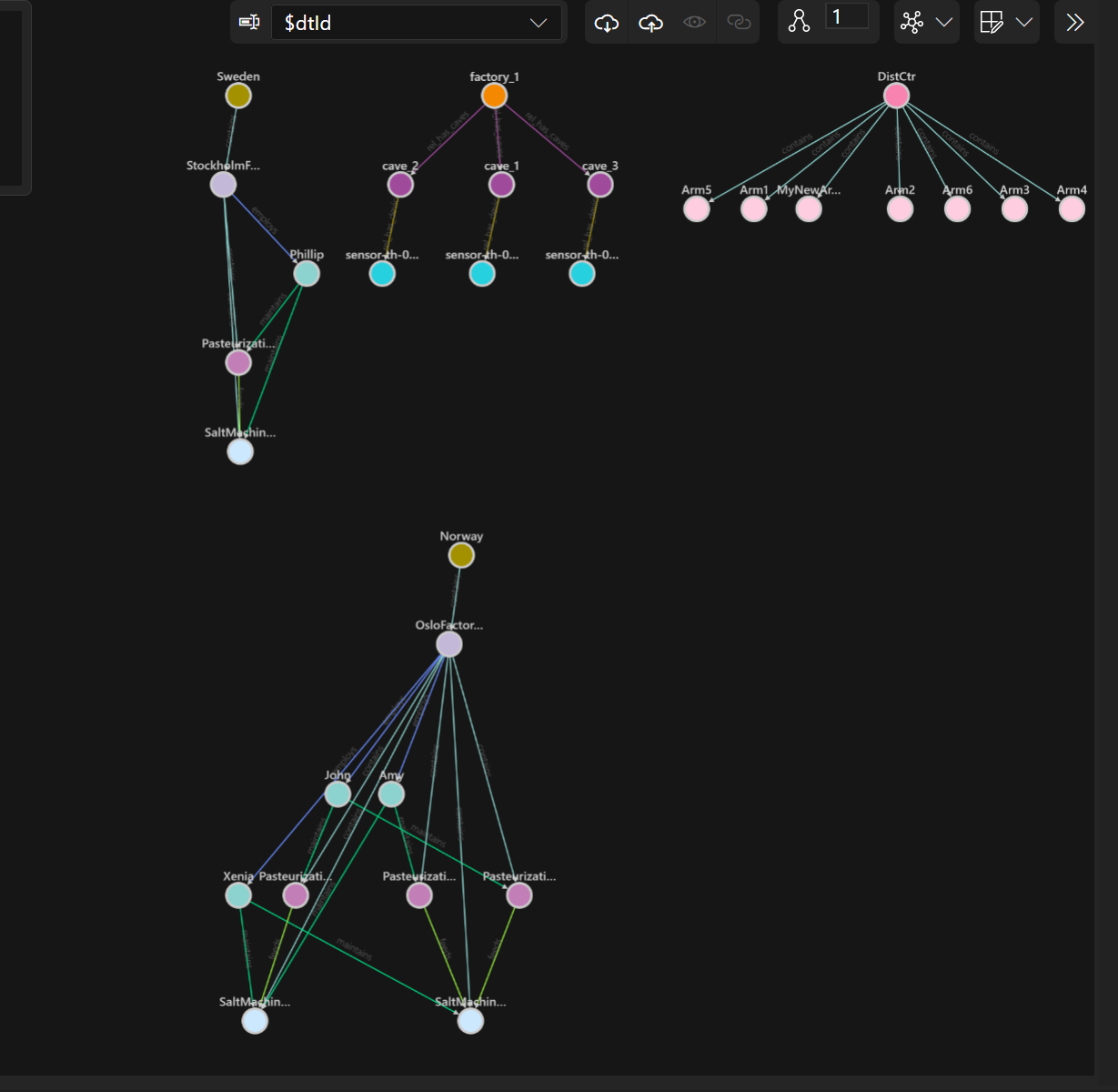

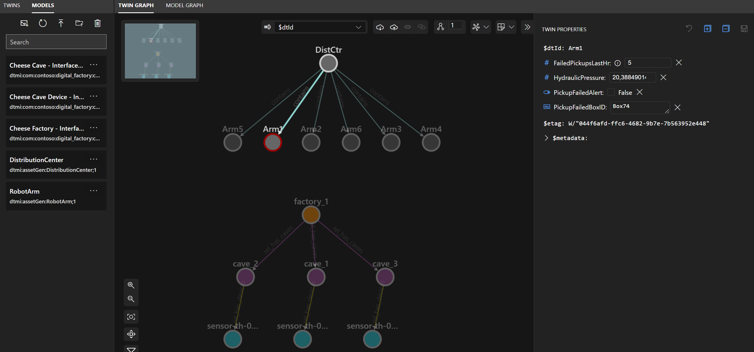

    Here I run the robot arm simulation, next to a model I created myself:
    In the graph explorer, it looks like this:
    As you can see, both new models and twins are preset. The twins are even updated with new property values.

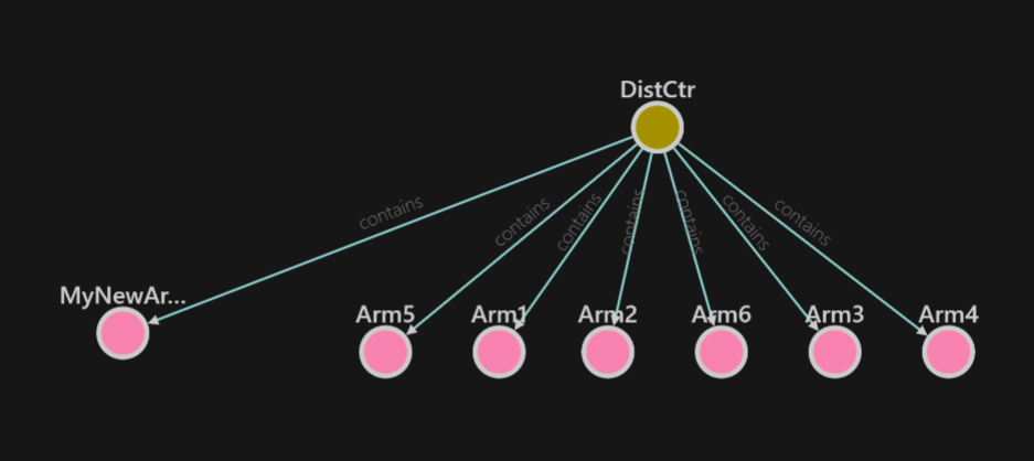

    As you can see, I can add a new twin:
    This twin will not be updates ofcourse, no logic is executed behind it.

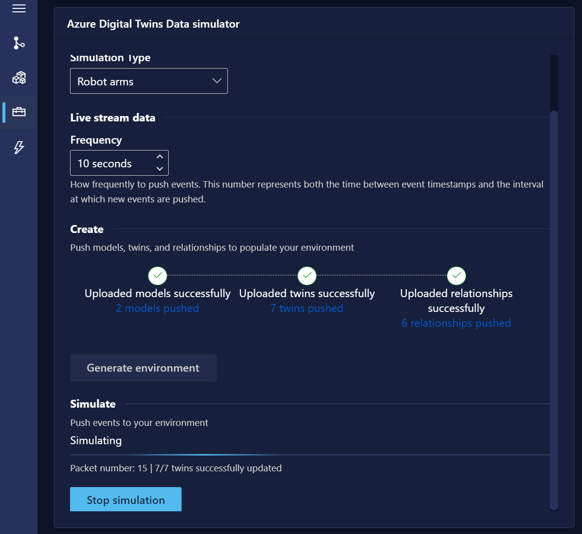

    You can also add the other demo, a dairy factory:
    The models are uploaded too.
    This one is also documented so you can try out the creation yourself.
