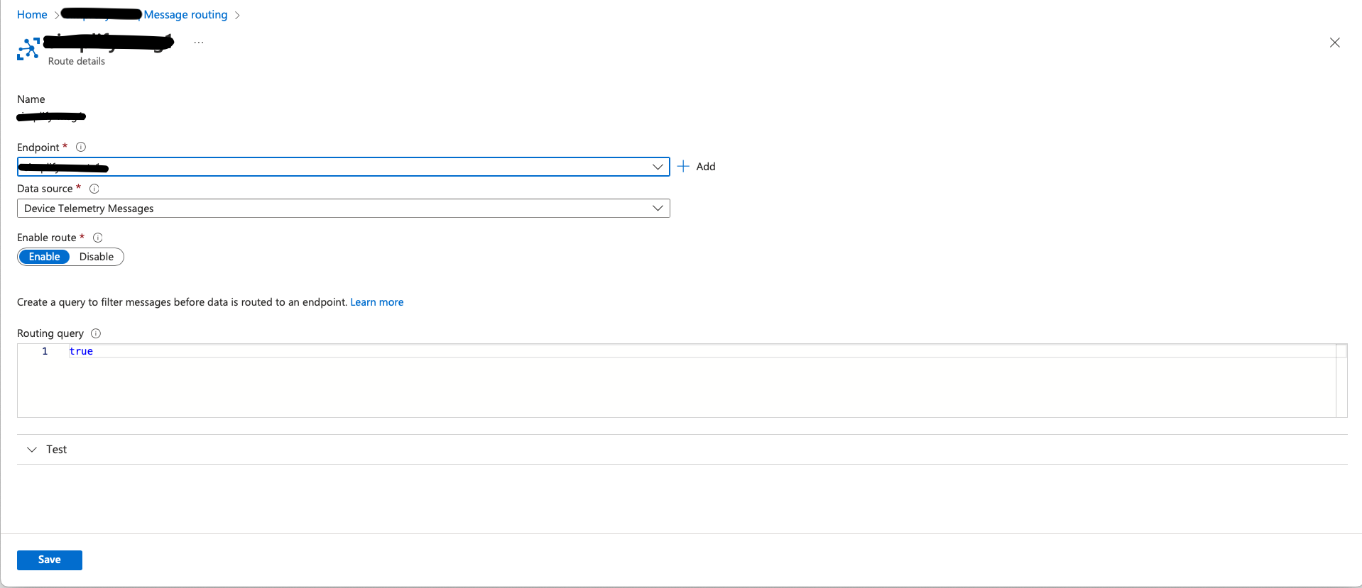

I have an issues with triggering functions by events from iothub edge devices. I need to run two functions that would listen on Edge device events but triggered according to the some quarry.
For that purpose on the IOT hub side I have created 2 Event Hubs with full shared access policies, 2 endpoints and 2 routes without any routing queries so at the beginning that both functions will get all the events, later I'll do the filtering. On the function side both functions are configured to be triggered by their own set.
@EventHubTrigger(name = "message1", eventHubName = "event1", connection = "AzureIotHubEvent1", consumerGroup = "$Default", cardinality = Cardinality.MANY)
@EventHubTrigger(name = "message2", eventHubName = "event2", connection = "AzureIotHubEvent2", consumerGroup = "$Default", cardinality = Cardinality.MANY)
However, no matter what I do only one function is getting events and the other getting nothing. I have checked and rechecked the configuration but it's haven't found anything there. Moreover, both Event Hubs Instances are getting the all the events.

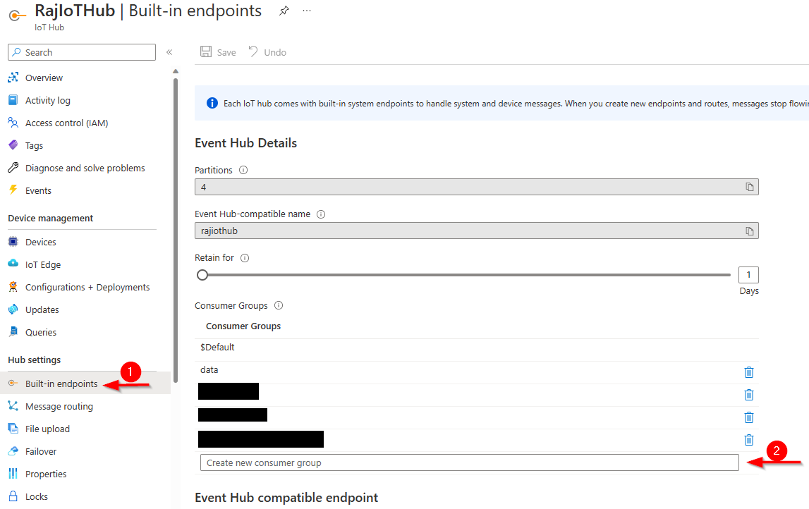

    The publish/subscribe mechanism of Event Hubs is enabled through consumer groups. A consumer group is a view (state, position, or offset) of an entire event hub. Consumer groups enable multiple consuming applications to each have a separate view of the event stream, and to read the stream independently at their own pace and with their own offsets.
    Instead of using the $Default consumer group to process Events routed to the Event Hub, create two unique consumer groups, one for each end point. Provide the created consumer group name in the function consumerGroup attribute. You can create the consumer group through your Azure Portal under the Built-in endpoints of your IoT Hub. Please refer the below image
    consumer group
