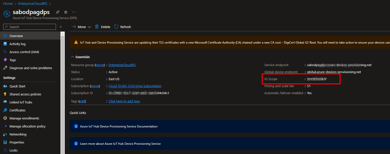

    Here is the repro of the scenario which i have tested to confirm on the initial query!
    I see that the Scope ID is same: For the DPS after the move to new subscription.
