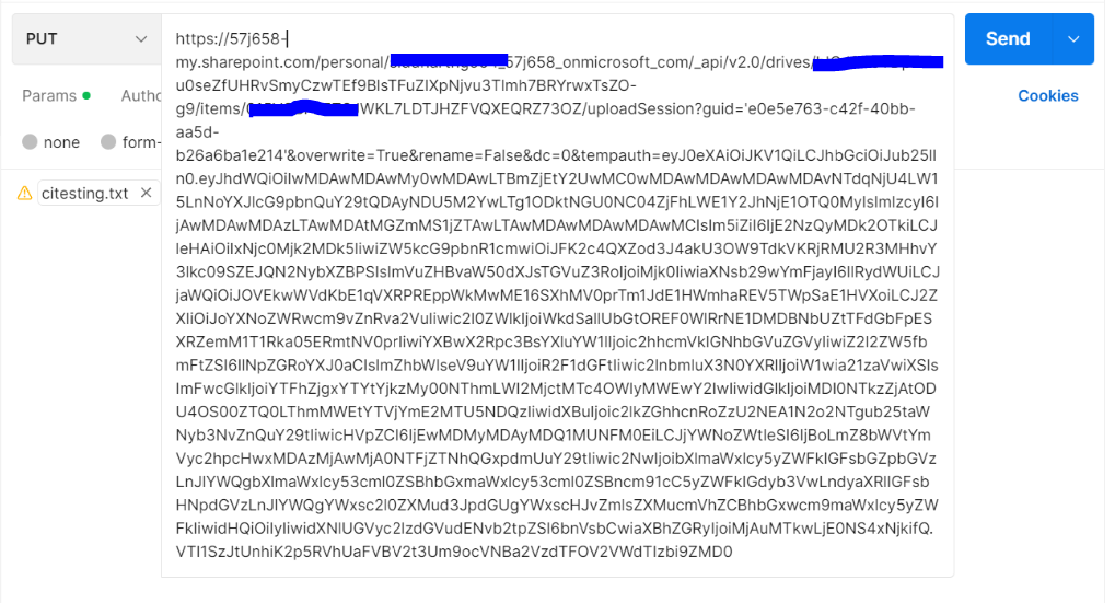

    1. While Using Graph Endpoint POST /me/drive/items/{itemId}:/{fileName}:/createUploadSession, in response we will get uploadUrl. pic1st

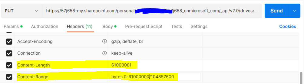

    2. To upload the file, or a portion of the file, your app makes a PUT request to the uploadUrl value received in the createUploadSession response. You can upload the entire file, or split the file into multiple byte ranges, as long as the maximum bytes in any given request is less than 60 MiB. 2nd

    6. The Content-Length header specifies the size of the current request.
    7. The Content-Range header indicates the range of bytes in the overall file that this request represents.

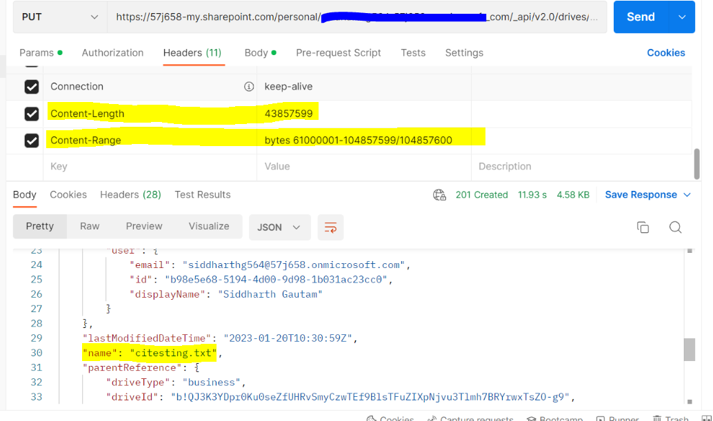

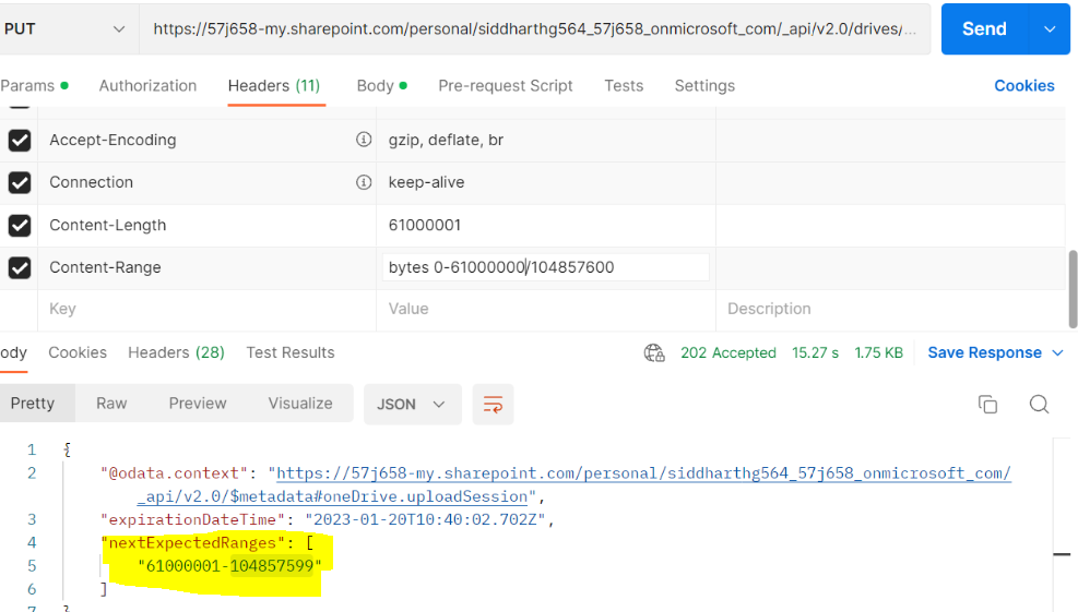

    • After setting up the header when we send the graph endpoint, we will receive nextExpectedRanges, if there are more byte ranges that need to be uploaded. pic55 Refer the link
    • Now in Content-Length you need to provide next remaining bytes to be uploaded less than 60Mib. and in Content-Range we need to provide next expected range what we get in response
