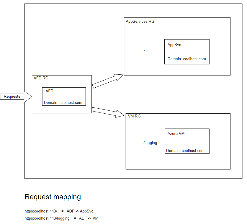

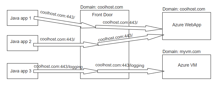

Hello everyone! I have the following infrastructure.
The main idea is to use the AFD as a proxy to forward traffic from the java apps to the different azure services (based on the endpoint path)
All the things that I was configuring in the AFD just redirected the traffic with the 3xx status.
And that shouldn't work for me because the Java app firewall allows only the coolhost.com host with the 443 port.

    I understand that you would like to know why your Azure FrontDoor is redirecting the backend pool URL.
    Per our discussion, I see that,
    • AppService also has a domain of coolhost.com.
    • And the Azure VM has a domain of myvm.com. (different from AFD)
    This issue can be expected from the VM as there is a domain mismatch between the AFD's custom domain and that of VM's.
    However, as long as AppService and AFD have the same domain, this issue should not be happening.

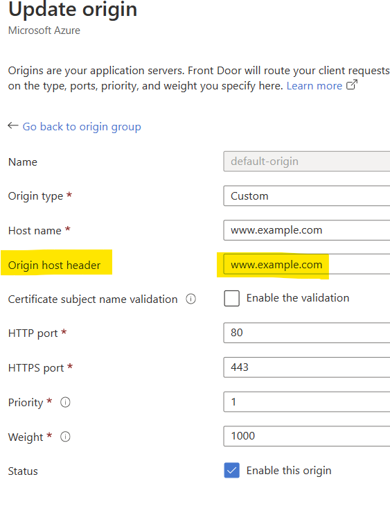

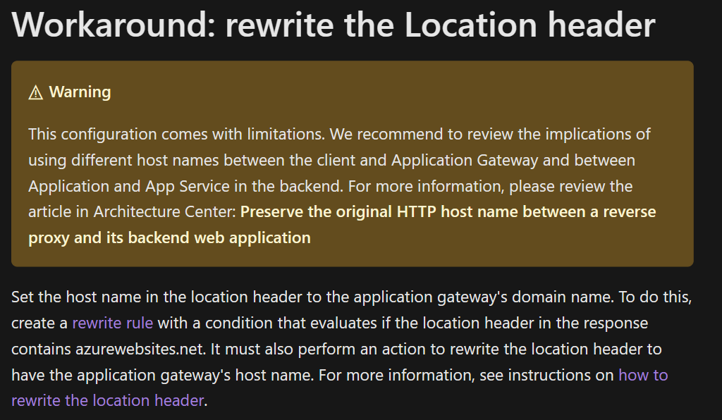

    Having a different host name at the reverse proxy (in our case, AFD) than the one that's provided to the back-end application server can lead to cookies or redirect URLs that don't work properly. For example, session state can get lost, authentication can fail, or back-end URLs can inadvertently be exposed to end users. This is what is happening in your case.
    The recommended solution for this issue is to preserve the original HTTP host name when you use a reverse proxy in front of a web application.
    Refer the below docs for more details on this issue:
    You wanted to know if we can have the same host name for AppService and AFD,
    Keeping the same domain for AppService and AFD is doable.
    This would require you to have a custom domain configured in the App Service.
    You can refer to Configure a custom domain on Azure Front Door using the Azure portal
    Check Under Azure pre-validated domain to get this configured
