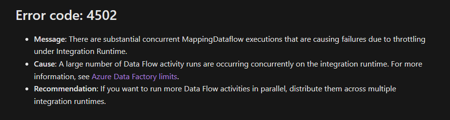

There are substantial concurrent MappingDataflow executions which is causing failures due to throttling under Integration Runtime.
Error code :4502.

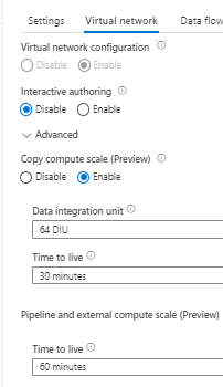

PL was running last 3 months and suddenly consistently failing with above error. I tried use high IR config to increase capacity limit and separate IR only for this PL. Data size is very small and some case no data at all.

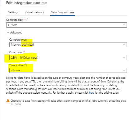

  1. Increased IR capacity limit
2.Created new IR only for this PL
