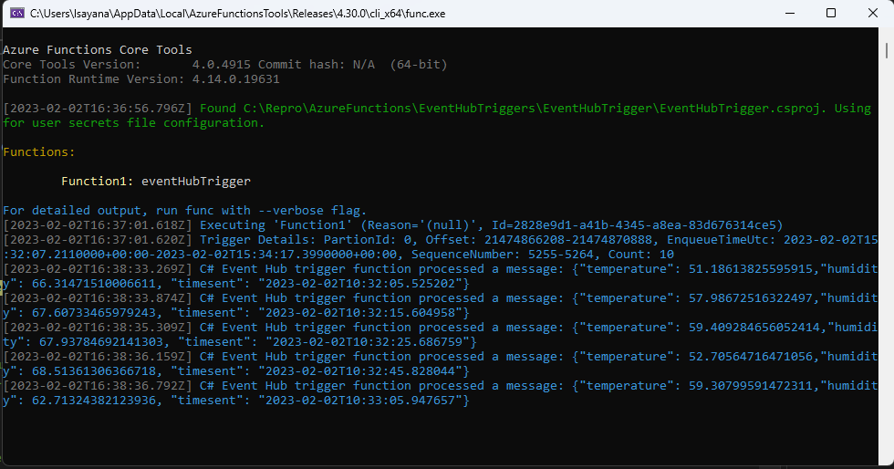

    Make sure you have an application pushing data to the IoT Hub and routed to the Event Hub end point. You can use the quick start guide and an SDK to Send Telemetry data to the IoT Hub for testing purposes. I have a Python SDK that pushes values to the IoT Hub which is running on VS Code. Here is the telemetry it generates.
    On the Event Hub Trigger function, I have put a break point where I am logging events. When I start the debugging of the application, notice the break point gets hit for every event delivered to the Event Hub.
    Notice the events captured by the function.

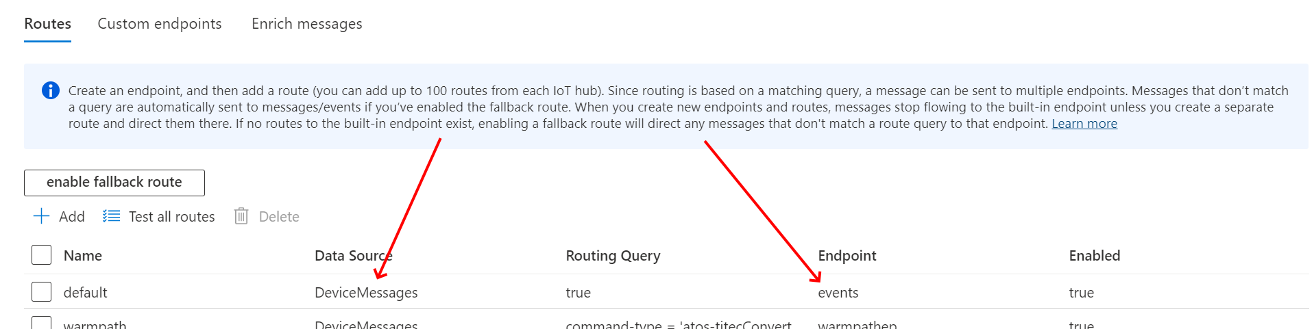

    Also, check the routing of the IoT Hub.
    If you add a custom route, the original eventhub endpoint turns into a fallback route.
    Repair this using that extra route:

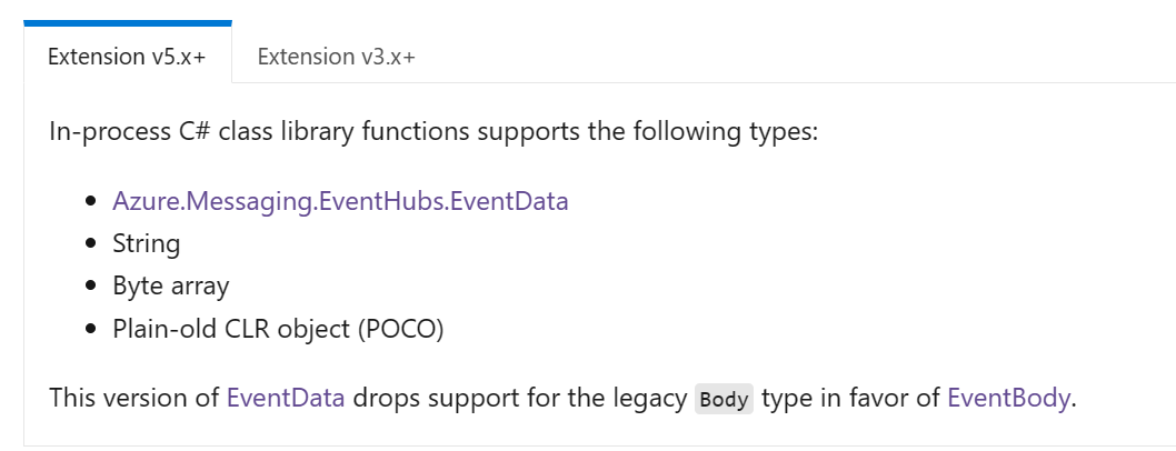

    The IoT Hub can send messages to an event hub too. There you can pick up messages using an Azure Function (using another kind of trigger, listening to EventHub messages).
    If you want to simulate messages coming from the IoT Hub, Just write some code that sends simulated messages to the same event hub.
    The messages will look like this class. The only thing that differentiates IoT Hub messages from your messages will be the (lack of) system properties.
