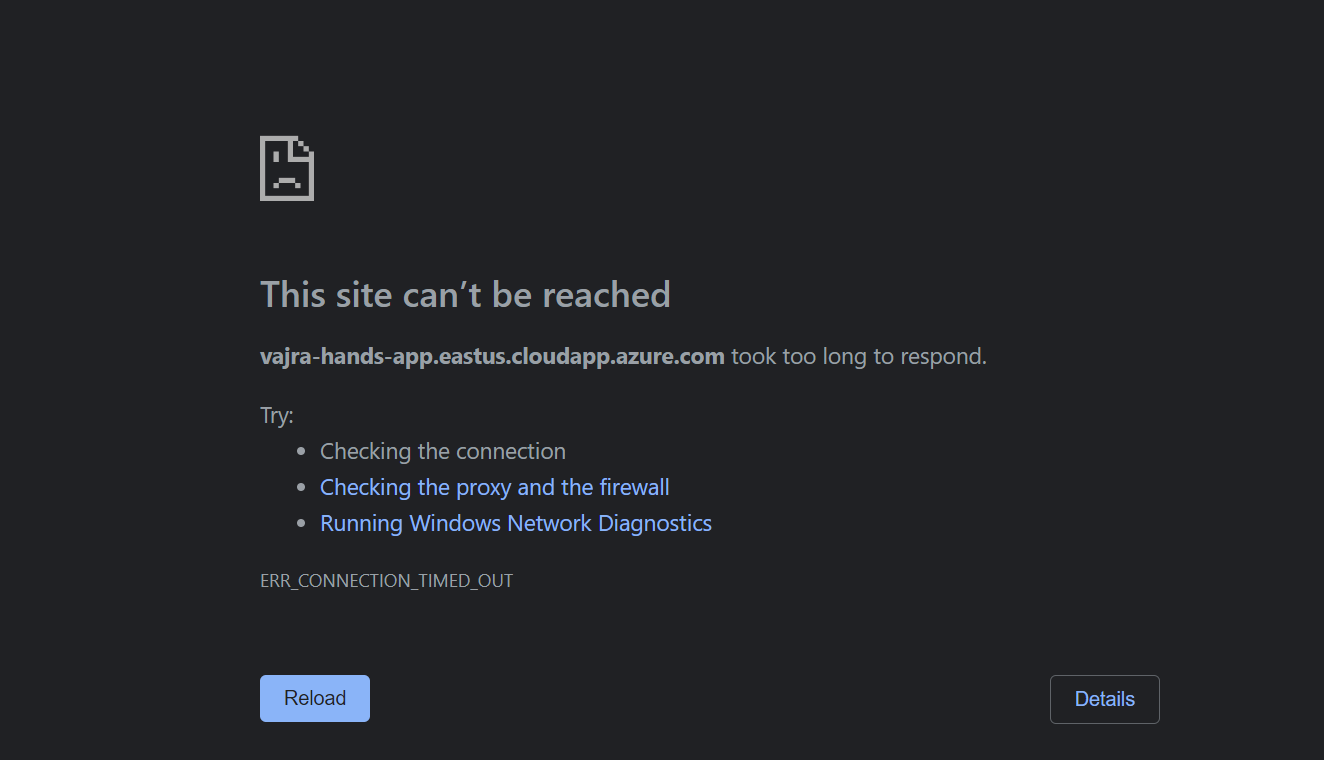

I have successfully deployed a react web application through Windows WSL on my Azure VM. But after when I configured the DNS name, the link shows, "the site took too long to respond". I am able to access the website via the public IP address of the VM though.
How can I resolve the issue?

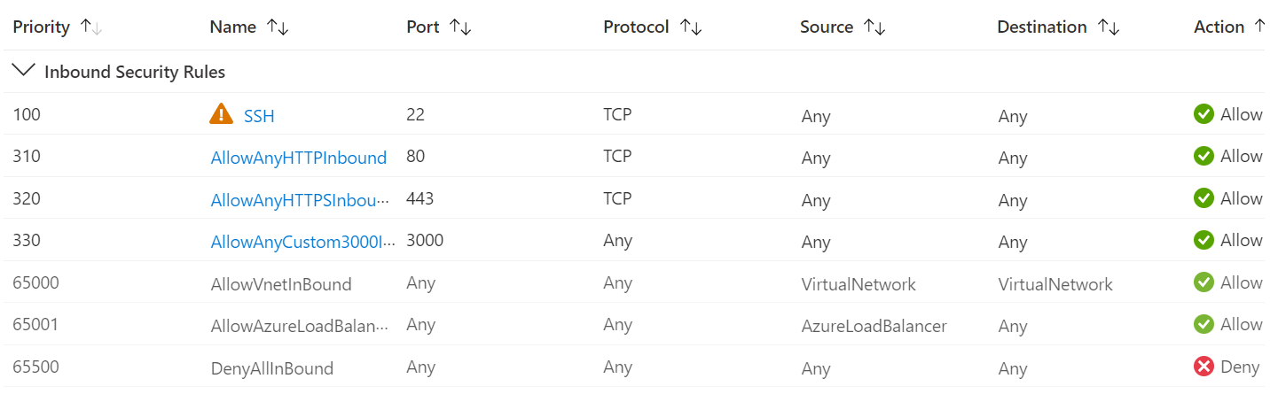

    did you open the ports through the NSG? what about the windows firewall?
    If you have any antivirus, try to disable too

    You mentioned "I am able to access the website via the public IP address of the VM though." this means the ports is open and is accessible.
