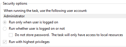

I have the below script which is run from User A (Local Administrator) and adds task to the scheduler (this part works fine). The server is then joined to a domain.
$userid = Join-Path -Path $env:UserDomain -ChildPath $env:UserName
$action = New-ScheduledTaskAction -Execute Powershell.exe -Argument '-File "C:\Folder\Run.ps1"'
$trigger = New-ScheduledTaskTrigger -AtLogon
$principal = New-ScheduledTaskPrincipal -UserId $userid -RunLevel Highest
$task = New-ScheduledTask -Action $action -Principal $principal -Trigger $trigger -ErrorAction Stop
Register-ScheduledTask TEST -InputObject $task -ErrorAction Stop | Out-Null
Upon reboot the script autologins (preconfigured) into the domain user and should resume the script it does not run.
If I try and use Set-ScheduledTask to change the user to Domain\User (before a reboot and after joining the domain) with the -User switch, it fails as the current user still is the local Administrator.
After reboot in place of Administrator below, it shows an SID and the task does not run until I manually change it to local account, or domain user.
Any thoughts on how to get this working on reboot even if accounts change ?!

  1. MotoX80 37,161 Reputation points
    2023-02-14T15:32:38.3333333+00:00
    Try using schtasks.exe.
    SCHTASKS.exe /Create /tn "Test"  /tr "Powershell.exe -noexit -ExecutionPolicy Bypass -File C:\Folder\Run.ps1" /ru interactive /rl highest /sc onlogon
    Update: I found my own answer. I knew that I had solved this at some point in time.
    Try this.
    $action = New-ScheduledTaskAction -Execute Powershell.exe -Argument '-noexit -ExecutionPolicy Bypass -File "C:\Folder\Run.ps1"'
    $principal = New-ScheduledTaskPrincipal  -RunLevel Highest -groupid   ".\administrators"
    https://learn.microsoft.com/en-us/answers/questions/573477/powershell-new-scheduledtasktrigger-cmdlet-atlogon?orderBy=Helpful

  4. touqeeranjum 80 Reputation points
    2023-02-15T08:47:41.1666667+00:00
    @MotoX80
    Thanks, works as expected, resumes script after reboot from a local account into a domain account.
