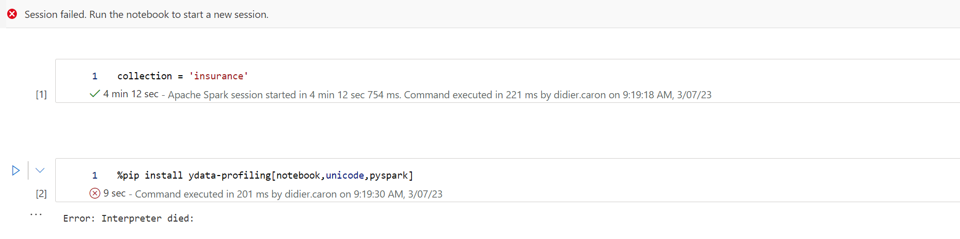

I am trying to use the ydata-profiling package from pypi and it requires a spark version of 3.3 when I run the %pip install ydata-profiling [notebook,pyspark] I get an interpreter died error. Install steps are described here https://ydata-profiling.ydata.ai/docs/master/pages/getting_started/installation.html

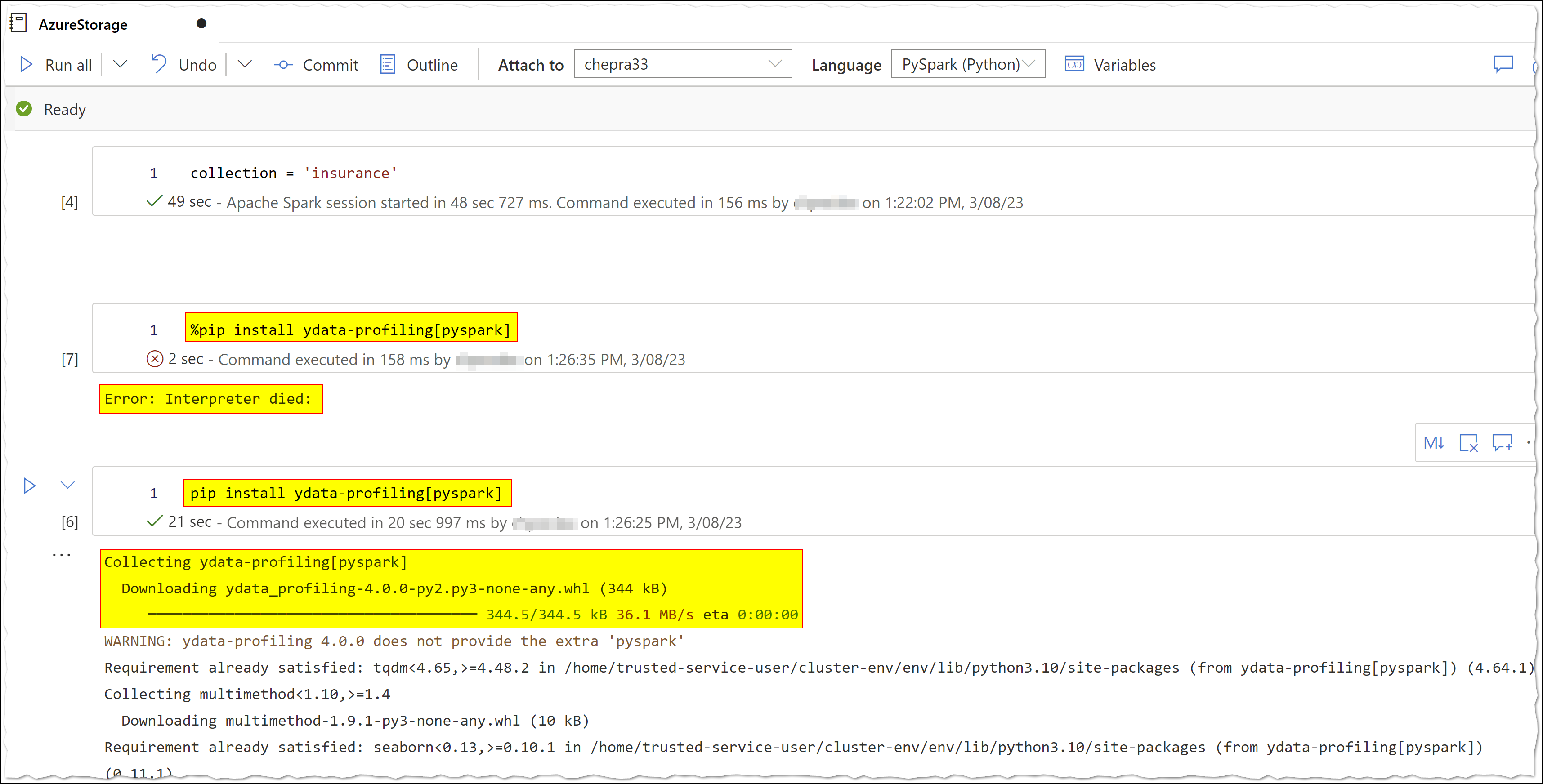

    As per the repro, I was experience the same issue when I used %pip and able to resolve the issue by using just pip
