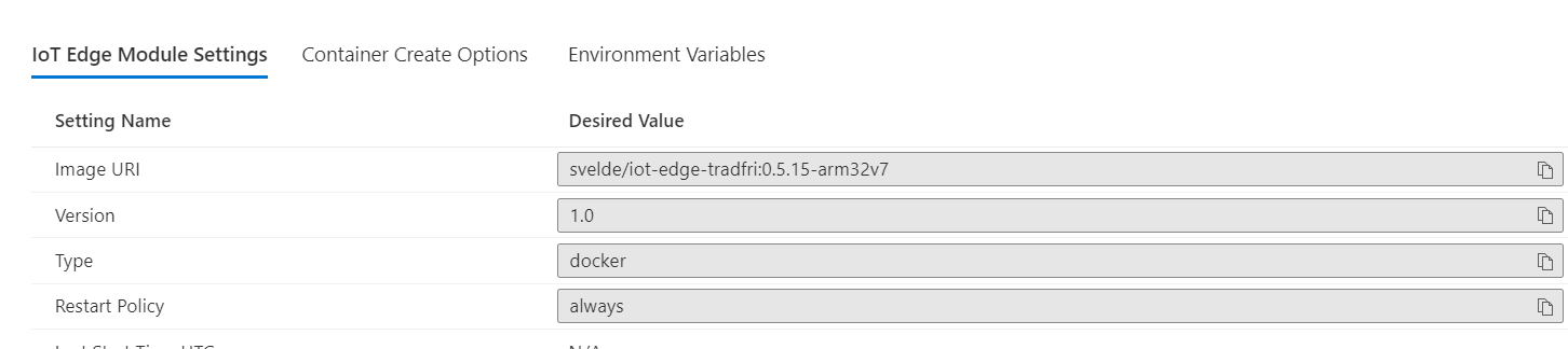

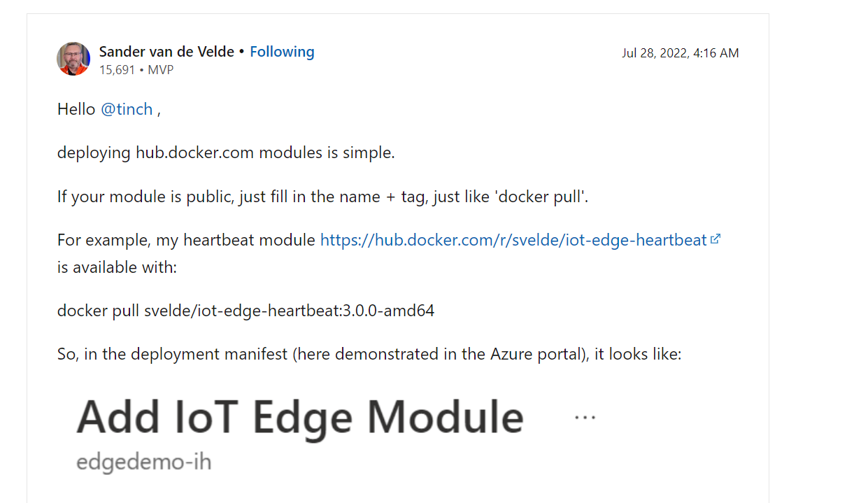

    containers put in Docker hub are supported by Azure IoT Edge.
    I expect you are already familiar with Azure IoT Edge and the deployment manifest.
    As with every container, you need to provide the name (and tag) in the Deployment manifest.
    Here is an example of public container:
    As you can see, I provide the docker hub account name along the container identification
    This is almost the same as an original pull request:
    docker pull svelde/iot-edge-tradfri:0.5.21-windows-amd64

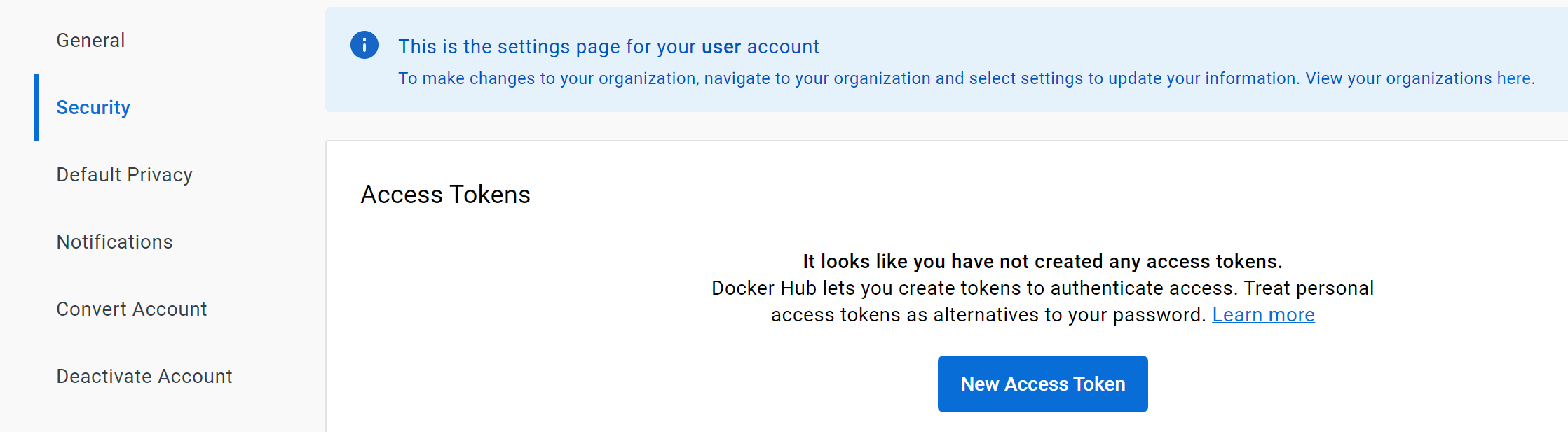

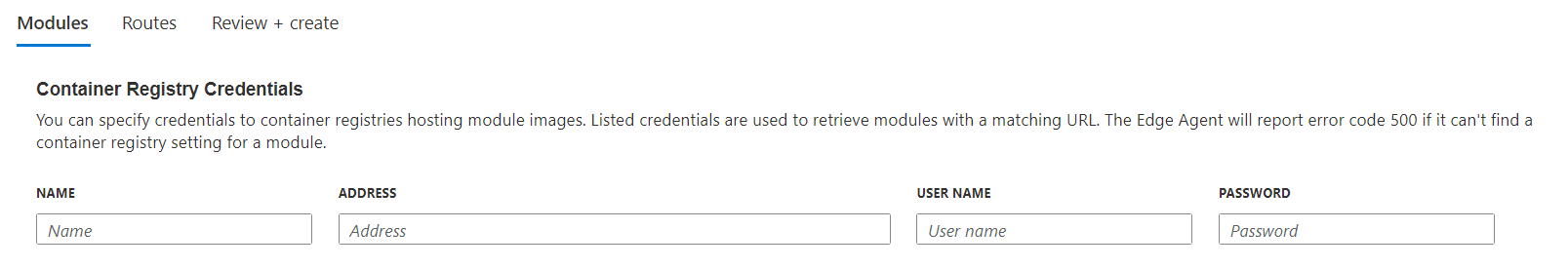

    If your container is made private in Docker Hub, you need to provide credentials to your private repository:
    I expect the address is hub.docker.com and the username is your account name.
    Regarding the password you could use your own password but I expect you need to create an access token if you want to be more flexible/secure.

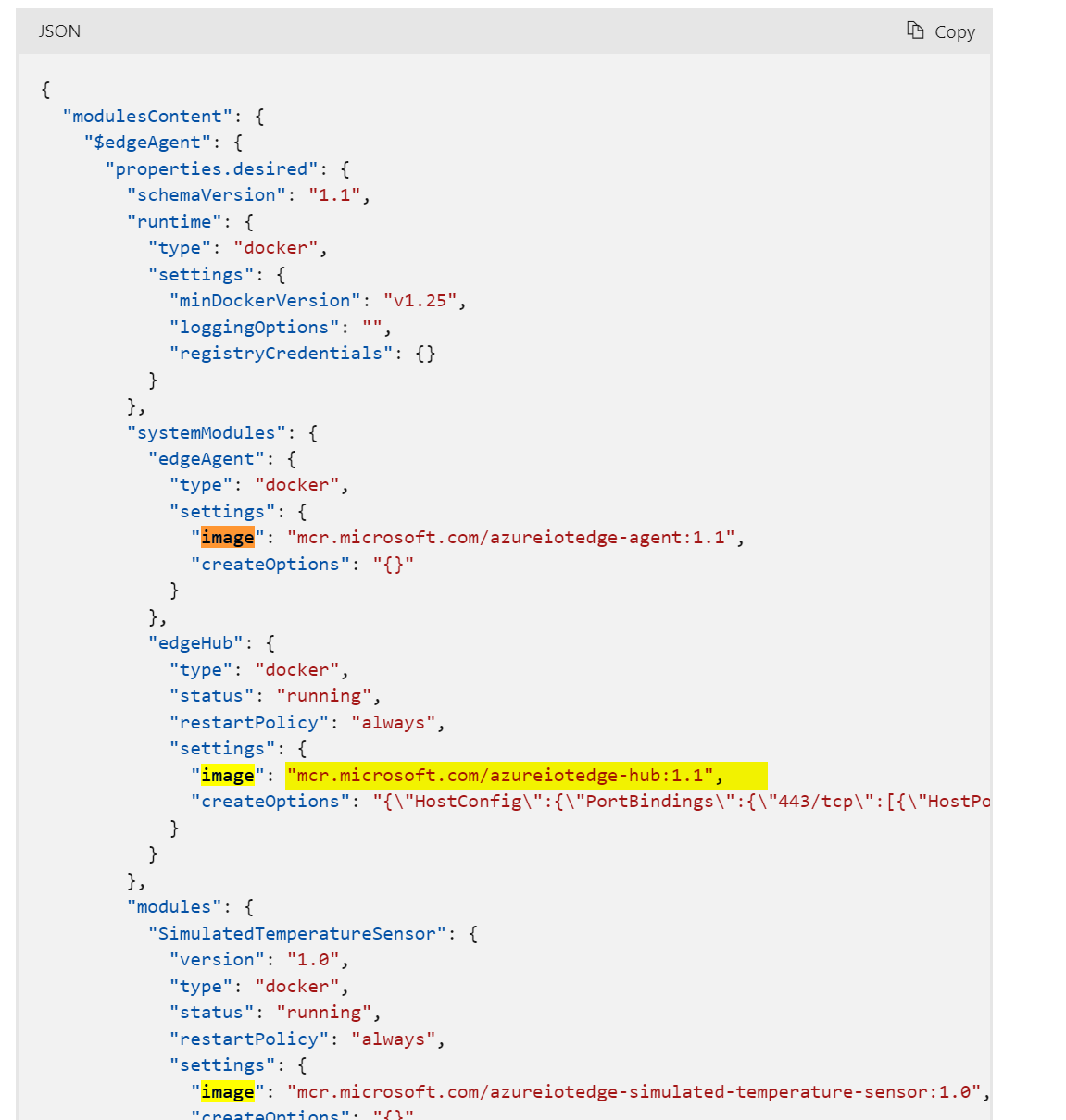

    • Create a deployment manifest:
    Deploy Azure IoT Edge modules from Visual Studio Code
    During the configure manifest step, you want to give the hub.docker.com address!
    Configure a deployment manifest
        "modules": {
            "my_module": {
                "version": "1.0",
                "type": "docker",
                "status": "running",
                "restartPolicy": "always",
                "settings": {
                    "image": "dockerhubusername/dockerhubimagename:tag",
                    "createOptions": {}
    Replace "my_module", "dockerhubusername/dockerhubimagename:tag" with your preferred module and container image name and tag.
