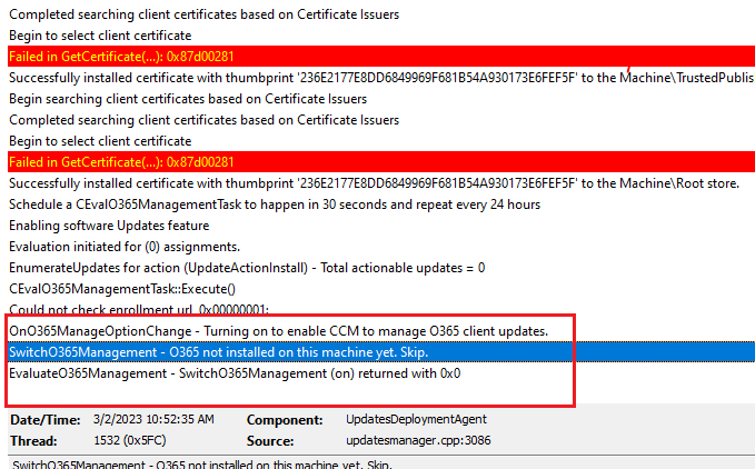

  4. Rouleau, Mark C 5 Reputation points
    2023-03-02T16:33:18.1666667+00:00
    I created a new VM with a stripped down version of our regular task sequence. See attached logs.

    UpdatesHandler.log
    UpdatesHandler-20230302-104855.log
