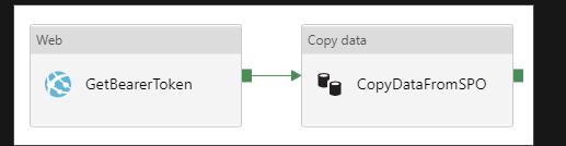

  1. Kumar, Satyam 0 Reputation points
    2023-07-13T13:19:12.3266667+00:00
    I noticed Bearer token is used here for authorization. I know manually we can generate it and it is valid only for an hour. Please let me know if there is a way to either generate Bearer token dynamically or if we can generate a bearer token with a longer validity period.
