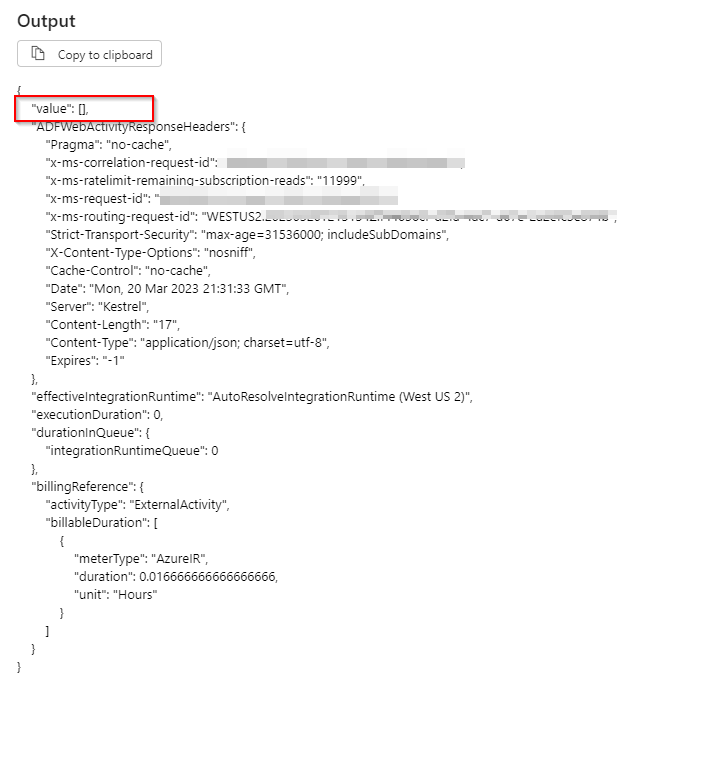

    The response from API would look like below:

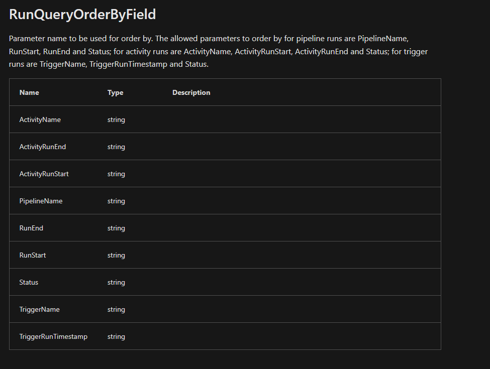

    In case if you multiple runID's returned, you can either try passing the closest recent run time of your querying pipeline or you can get add orderBy parameter in your request using RunStart and order = DESC
    One you have the Web activity response, then you can extract the latest or most recent pipelinerunID and its status by using below dynamic expression.
    For retrieving pipeline run ID:
    @activity('web_GetPipelineRunDetails').output.value[0].runId
    For retrieving pipeline run status:
    @activity('web_GetPipelineRunDetails').output.value[0].status

    3. Related doc: https://learn.microsoft.com/en-us/rest/api/datafactory/pipeline-runs/query-by-factory?tabs=HTTP#runqueryorder
