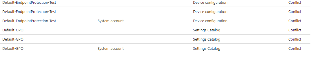

I have a configuration profile for bitlocker where I am getting some conflicts. I am wondering how to narrow down the conflicts based on the information that I have.

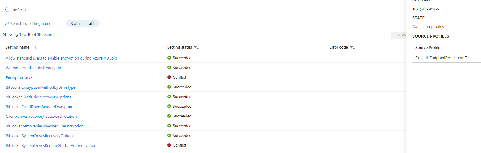

Here is the conflict for encrypt disk:

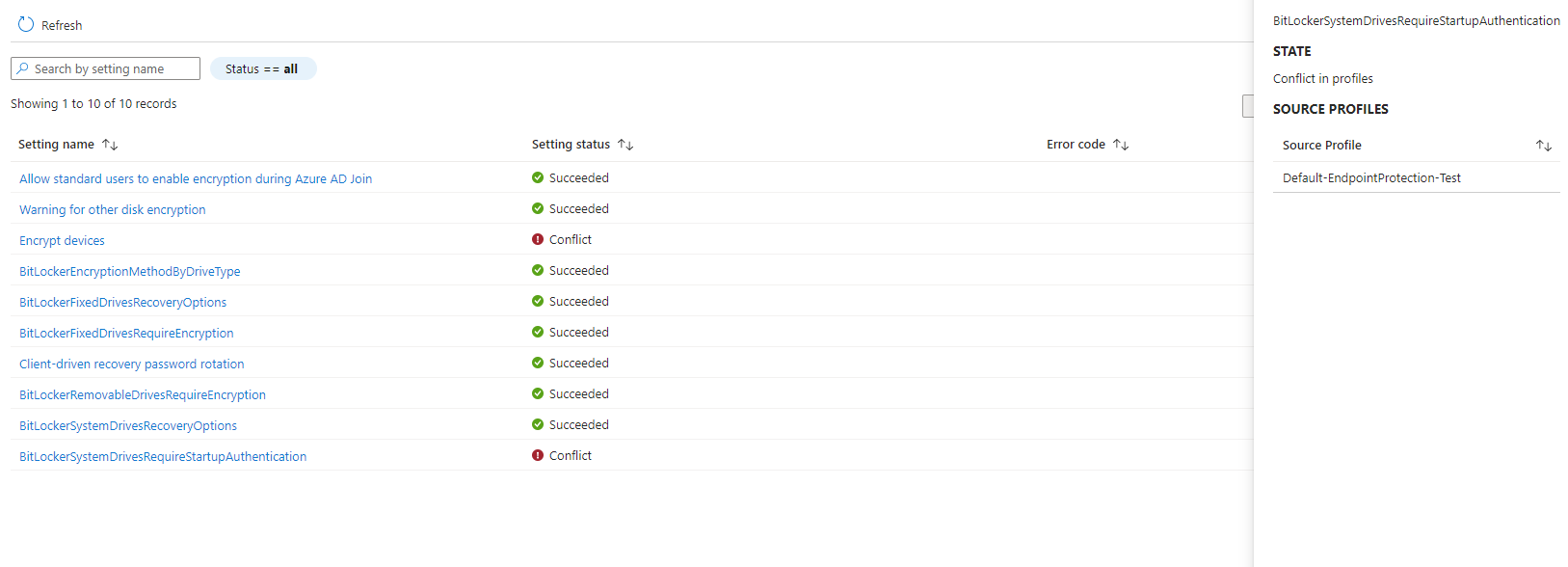

And here is the conflict on requires startup auth:
I am wondering if this is a conflict with our default GPO that is being applied to the device or if it is an issue with the device itself.

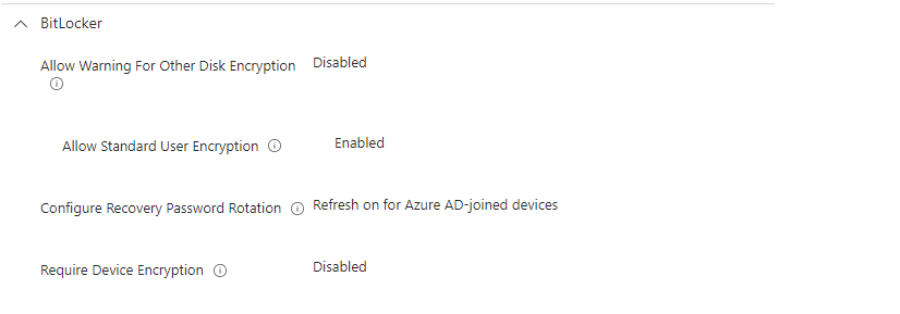

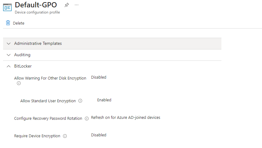

Here is the GPO:

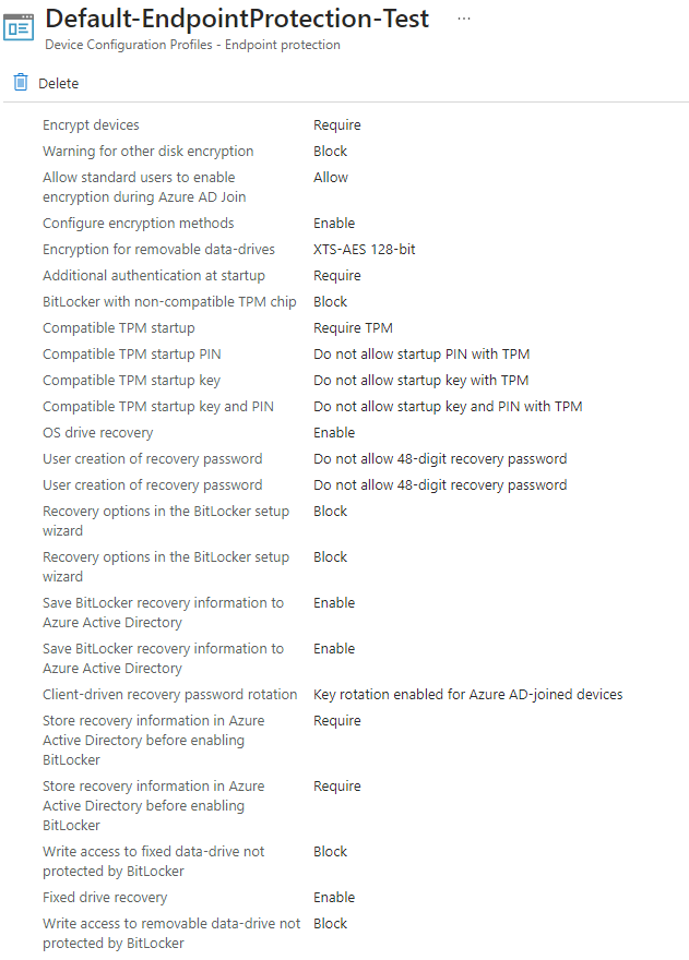

Here is the configuration policy:

    ==>By device profile report do you mean Device Configuration? If so it does show me that there is a conflict, though it does not show which profiles are in conflict:
    Yes, this makes sense. The setting "require device encryption"=disabled in configuration profile labeled "Default-GPO" is in conflict with the setting "encrypt devices"=require in "Default-EndpointProtection-test" configuration profile. Please also check other settings in "Default-GPO" configuration profile.

    1,==>I am wondering if this is a conflict with our default GPO that is being applied to the device or if it is an issue with the device itself.
    The conflict setting status in Intune means the BitLocker policy conflicts with another BitLocker Policy or Security baseline in Intune, it does nothing with GPO here.
    We can use below two policy types to configure BitLocker on your managed devices, please check if there is any conflict policy:
    Endpoint security disk encryption policy for BitLocker.
    Device configuration profile for endpoint protection for BitLocker.
    2,Some versions of the security baseline for Microsoft Defender for Endpoint will configure both Compatible TPM startup PIN and Compatible TPM startup key by default. These configurations might block silent enablement of BitLocker. If you deploy this baseline to devices on which you want to silently enable BitLocker, review your baseline configurations for possible conflicts.
    In device profiles report, you may see per settings which configuration profiles are in conflicts to solve issue. The most case is when a baseline is different with a device profile for the same setting as example.
