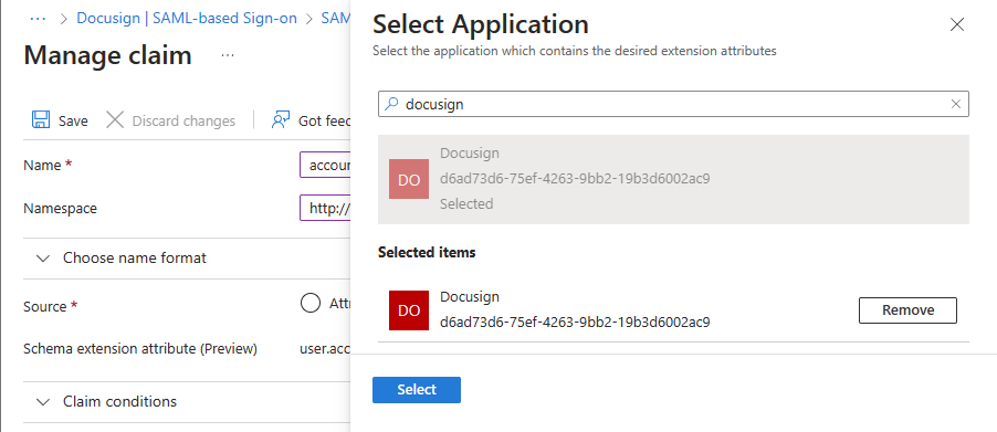

    Using Directory Extensions:
    • Add new claim
    • Source it from Directory schema extension (preview)
    • Select the DocuSign enteprise application or the application where the directory extension was created:

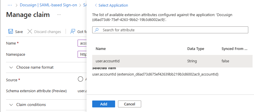

    • Select extension attribute:
    • Click Add
    • Click Save
