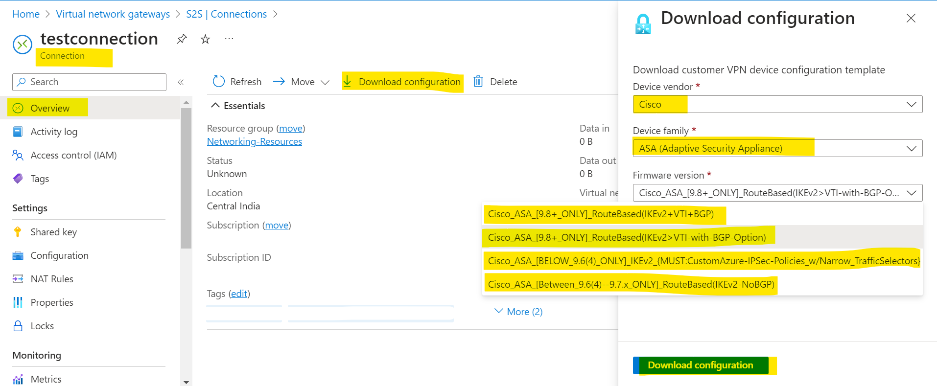

    If you need help with Cisco side configuration script, you can download a configuration script for your VPN device from Azure portal with the corresponding values of your Azure VPN gateway, virtual network, and on-premises network address prefixes, and VPN connection properties, etc. already filled in.
    Refer: https://learn.microsoft.com/en-us/azure/vpn-gateway/vpn-gateway-download-vpndevicescript
    You can go to the site-to-site connection of your VPN gateway in Azure portal and on Overview pane, select Download configuration and then select the device vendor, device family & firmware version to download the configuration script for the required device. You can choose Cisco ASA VTI with BGP or some other option depending upon your requirement.
