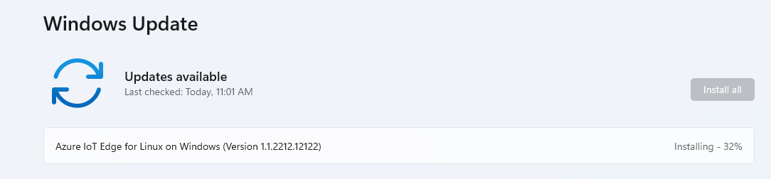

    One observation I would like to note is that the update doesn't support migrations between the different release trains. If you want to move from the 1.1LTS or 1.4LTS version to the Continuous Release (CR) version or viceversa, you'll have to uninstall the current version and install the new desired version as mentioned in the documentation. If you were not on Azure IoT Edge 1.1LTS (1.1.2212.12122), I would recommend following the steps outlined in Update using Microsoft Update to get to the Azure IoT Edge LTS version of 1.1
    Please refer the below screenshot showing the initial 1.1 version I have configured with, and the updates being installed for the Azure IoT Edge after enabling the above option and checked for updates.
    Screenshot_103
    Screenshot_106

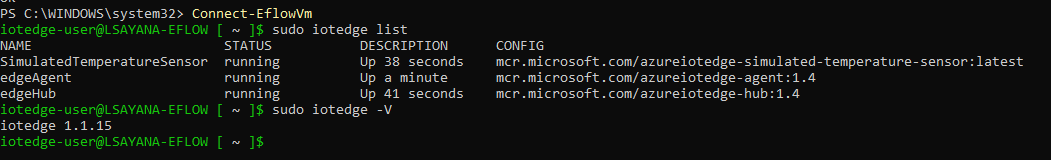

    Once you are the Azure IoT Edge 1.1LTS build, you can execute the Start-EflowMigration command to update the IoT Edge to 1.4 version. Please find the below screenshots from my testing
    Screenshot_107

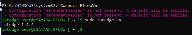

    I then confirmed the Migration using Confirm-EflowMigration command. I could confirm that Edge version gets updated by connecting to the Eflow.
    Screenshot_112
