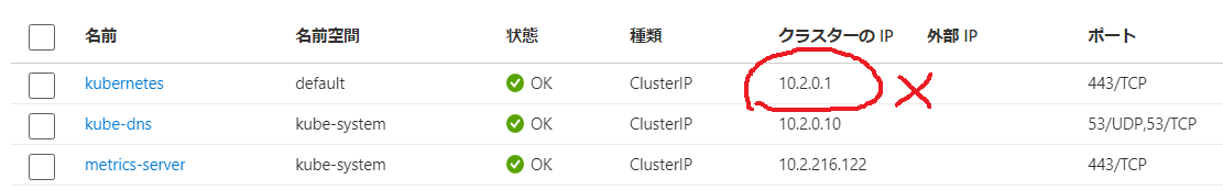

    I would like to solve the problem of not being able to connect to the container with the IP address of 10.2.0.1 (cluster IP) in the same cluster.capture

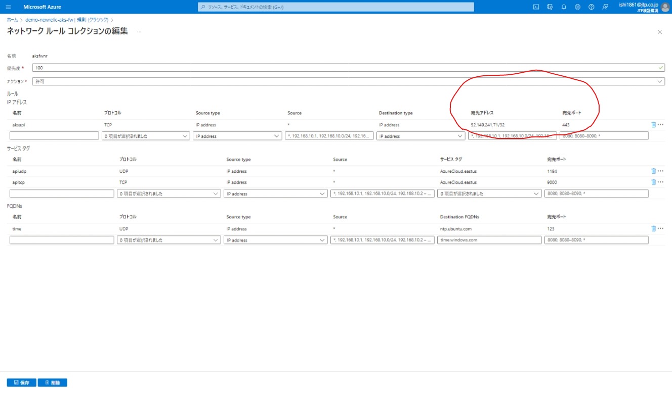

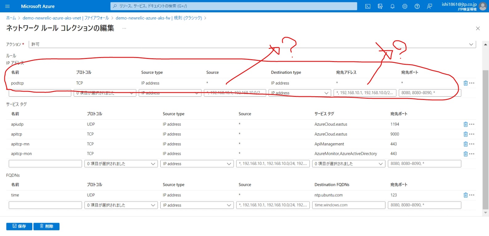

    Web キャプチャ_10-4-2023_101853_portal.azure.com Of course, the problem can be solved by setting wildcards for the source IP, target IP, and destination port in the network rules of the firewall. However, instead of that, I would like to restrict it by setting appropriate IP addresses for the source IP and target IP.enter image description here Could you please provide me with instructions on how to do so?

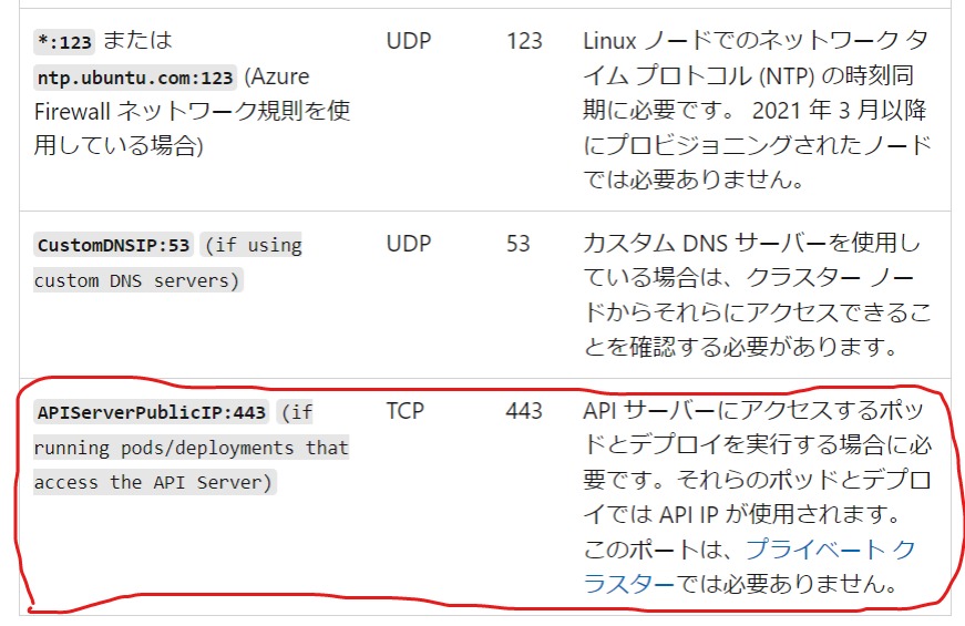

    We have resolved this issue.

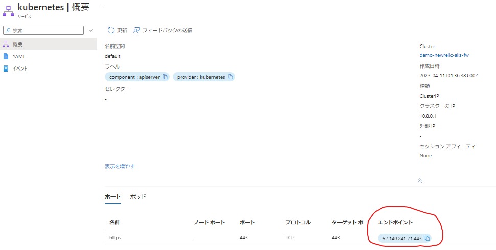

    The cause was that we were unable to communicate with the IP address of the API server that was assigned when we created the AKS cluster (Figure.1,2).
    Therefore, we added the IP address of the API server to the network rules of the firewall to allow communication (Figure.3). Figure.1)Web キャプチャ_11-4-2023_142034_portal.azure.com
    Figure.2)Web キャプチャ_11-4-2023_122930_portal.azure.com
    Figure.3)
    Web キャプチャ_11-4-2023_12480_portal.azure.com

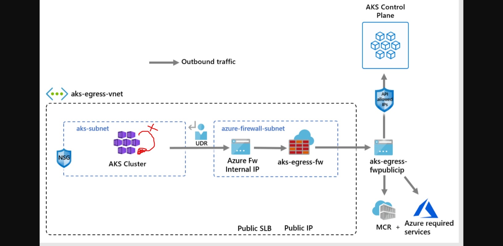

    I overlooked the fact that the aforementioned configuration was properly mentioned in the following URL (Figure.4). https://learn.microsoft.com/ja-jp/azure/aks/limit-egress-traffic#required-outbound-network-rules-and-fqdns-for-aks-clusters
    Figure.4)
    Web キャプチャ_11-4-2023_12537_learn.microsoft.com
