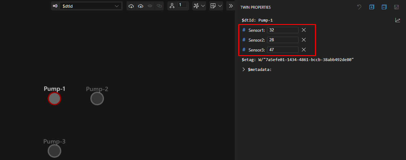

    Please make sure to provide your Azure digital twin instance URL for the variable adtInstanceUrl The code sends simulated data to the Digital twin every ten seconds
    Once you have application running, you can see the Twin properties values update every ten seconds on the Azure Digital Twin explorer. User's image
