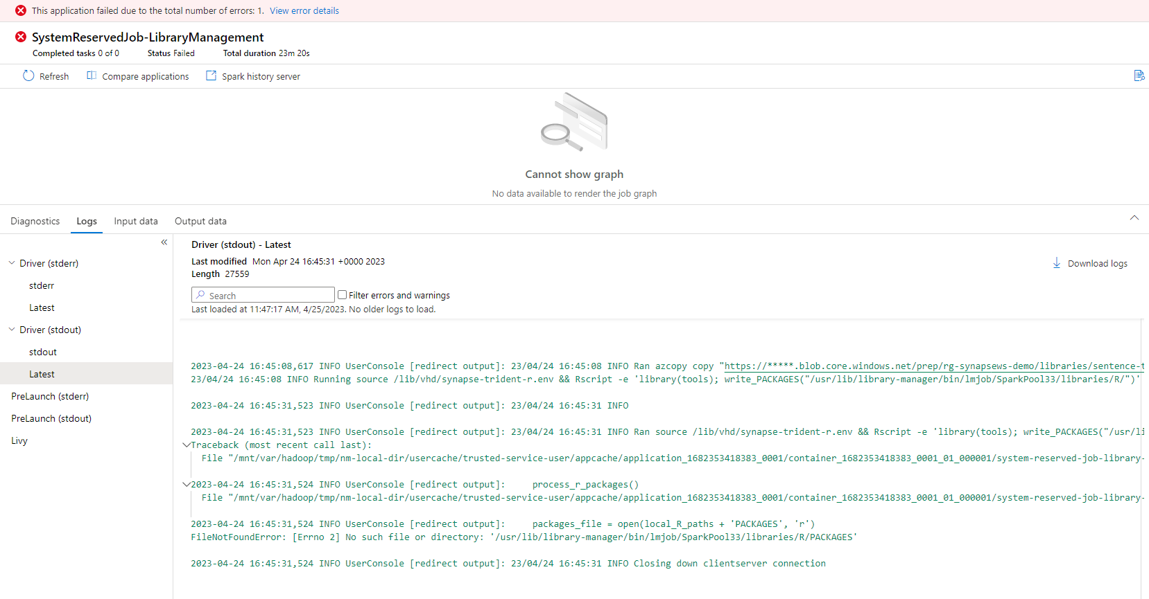

I'm trying to install sentence-transformers python package as a workspace package for Azure Synapse Analytics.(To be used on Apache Spark Pool) Tried installing it through magic command %pip install sentence-transformers through a notebook and it works. Following the steps for uploading the sentence-transformers-2.2.2.tar.gz to Workspace and configuration throws the following error mentioned in the screenshot. I tested with couple of other python packages and they work fine. Any workarounds? synapse_error

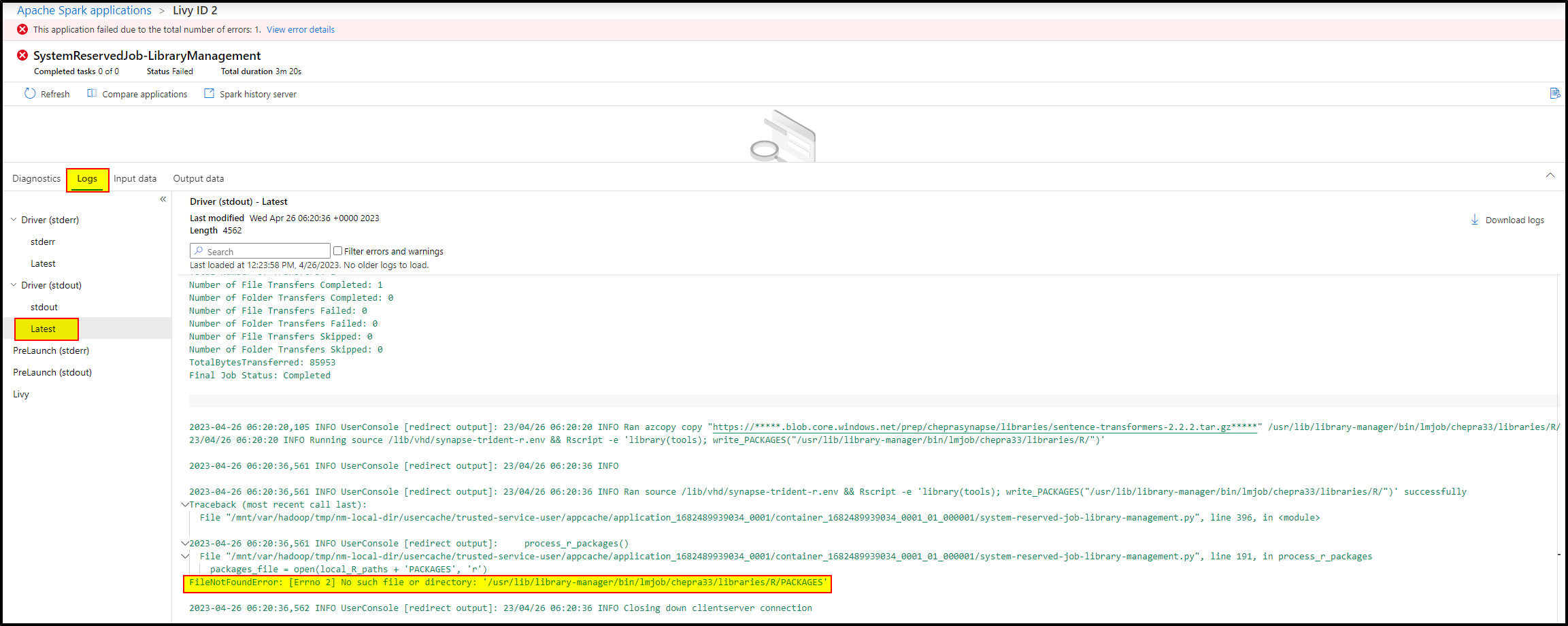

    Looks like there is an issue with install whl file, which would leads to Job failed during run time with state=[dead] File not found. Please validate that file at the provided path exists and that you have the permissions required to access the file.
    As per the repro, I had tried to install the sentence-transformers-2.2.2.tar.gz whl file via workspace packages where I got the same error message as shown above. I will reach out to the internal product team to get more details on why exactly we are experiencing this error message. User's image
