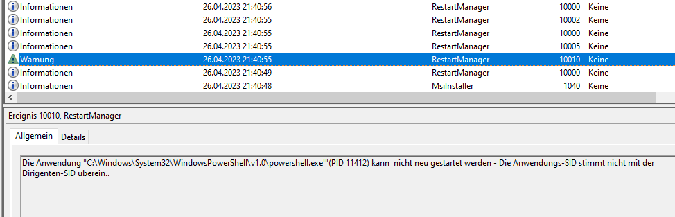

The eventlog on the server:
And the warning shows:

    I added the logging option as you suggested ( /l*v log.txt ). In the logfile i found the entry:
    Will attempt to shut down and restart applications because the UI does not display any modal dialogs.
    Successfully shut down all applications in the service's session that held files in use.
    Successfully shut down all applications that held files in use.
    We have already tried a server-restart (several times) - but with no success.
    Here is the detailled log entry - the timestamp as the powershell-session was shutdown was 07:48:11:
