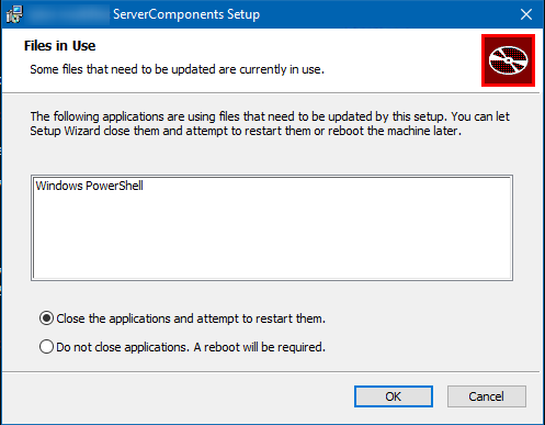

We have a powershell-install script, that installs automatically our application-msi at a Windows Server 2019.
This script worked fine. For a few months, the script/powershell-session has been aborted during execution of the msiexec command. The installation with msiexec completes successfully, but the powershell-script is closed.

The eventlog on the server:
And the warning shows:
I did not find any solutions until now.
Can anyone help me to find out, what's the reason for this issue?

    It would appear that something else is the script is opening a handle to something that the MSI restart manager wants to update, and it is terminating the Powershell process.
    What does the script do before it hits the try/catch portion that you posted? Can you simplify the script to just call msiexec?

    On the problem server, RDP to it and run the script interactively. Remove the /passive switch from the msiexec call and let it display the UI. Do you get a prompt that says that it needs to terminate Powershell.exe because it has an open handle?

    I found it (ahhhhh).
    The solution was your last answer (remove the /passive argument) in combination with the handle.exe to specify which files are locked.
    On our application server i have to determine which version of our application is installed and then it would only be shown the "newer" created versions. To get the version of the dll i used the powershell-command:
    $Assembly = [Reflection.Assembly]::Loadfile($filename)
    and this command locks the file ... and the handle.exe did correctly show this file as locked:
    B7C: File (R-D) C:\inetpub\wwwroot\WebServicesRoot\ServerConfigurator\bin\MyApplication.exe
