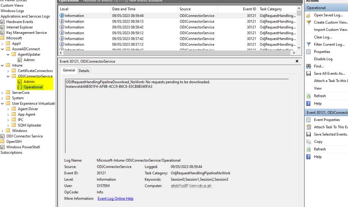

HI,
I'm try to build machine using Autopilot but its keep failing with error code 8007002
How it setup

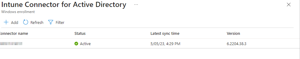

  • Build new 2022 Server Download and install Intune Connection App (This is showing as Active in Autopilot). Assign computer OBJ permission for this server on OU which will have these machine listed as Full control for Computer OBJ
  • Turn created device group "(device.devicePhysicalIDs -any _ -contains "[ZTDId]")"

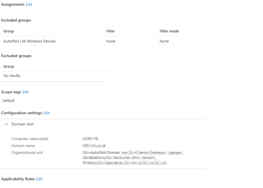

  • Created new deployment profiles and assign to above group

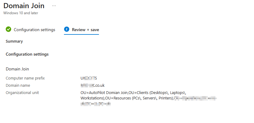

  • Create new "Configuration profiles" Domain Join and assign to above group
But its keep failing
Also
Device does not have any license assign to it.
The account which i'm using to login has E3 License

  1. Crystal-MSFT 53,991 Reputation points Microsoft External Staff
    2023-05-08T02:32:33.2833333+00:00
    @lalajee, Thanks for posting in Q&A. Based as I know, this error can occur in a Hybrid Azure AD join scenario if the computer name prefix was incorrectly configured in the Domain Join Profile. For the Hybrid Domain Join you currently cannot use any variables like %SERIAL% or %RAND%, but only a simple Prefix such as TEST-, HAADJ- or ABC- with or without a dash. If you attempt to use a variable, you will get “Server Error Code 80070002”. Please confirm if the Computer name prefix is set correctly.
    Meanwhile, the error code 0x80070002 can also occur if you have a space on the domain name. Please check this to see if we have the same issue.
    Please try the above suggestions and if there's any update, feel free to let us know.
