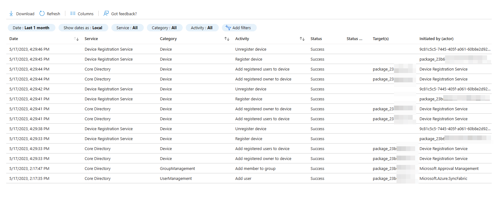

In the audit log, I see that the device joins and after a while the application removes it.
msedge_1sBdejyfFG

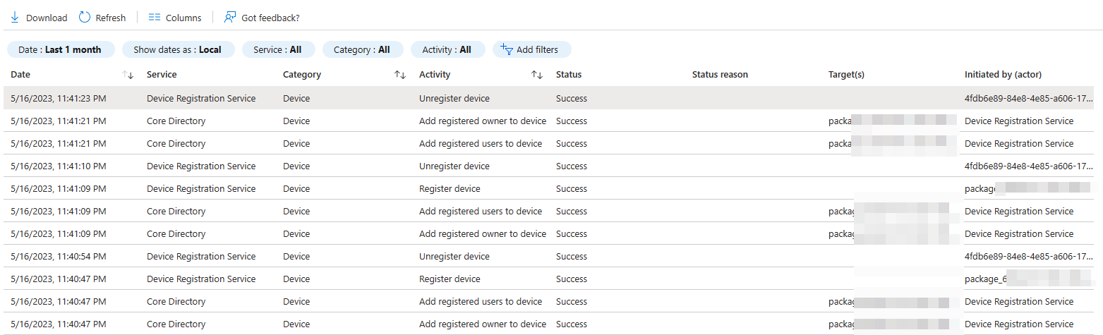

I didn't find what app it is. I can't find it by ID. I suspect that I have increased the number of devices allowed.
msedge_6c7vN5IWny
Therefore, this limit was magnified, it seems that you need to wait a while.
