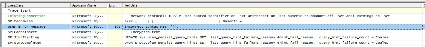

Sometimes when connecting the application via mssql-jdbc-9.4.1.jre8 errors "incorrect syntax ')'" appear, although the prepared query and procedure definition are correct.
Errors appear randomly. Stored Procedures can execute correctly several dozen times, and that an error appears in 2 or 3 subsequent executions. After that, the procedure works fine again (object definition hasn't changed)

  2. Andrej Kuklin 10 Reputation points
    2023-09-15T12:10:10.13+00:00
    We experienced the same issue on a fresh SQL Server 2022 CU5 instance. The database was transferred with backup/restore from a SQL Server 2014 instance. The instance was set up with CU5, no CU were installed after the database was restored. No trace flags, no database scoped configurations, only set compat level to 160 and activated the query store. Also, no manual query store hints/plan forcing for individual queries.
    The issue surfaced on 2 databases and 4 different queries, but it's still a relative rare case as these databases run 100K queries each day. All queries were syntactically fine; a rerun was always successful.
    We've opened a support case with MS (TrackingID#2309050010002020) and deactivated the query store on one of the databases where the issue was happening each day. The deactivation helped.
    MS Support confirmed that it's a known issue and the work on the patch was in progress (first half of September 2023) with no known ETA.
    As an alternative to disabling of query store they also suggested activating the trace flag 12601 to disable QDS statement hints. I've done this on a test server and it seems to make the error go away (not 100% sure, because it was for another database where the issue surfaced only once).
    I'll anyway probably prefer to deactivate the query store for a database experiencing the problem rather than changing an instance-wide setting, which will also have side effects on other databases, but I still wanted to have this alternative tested.

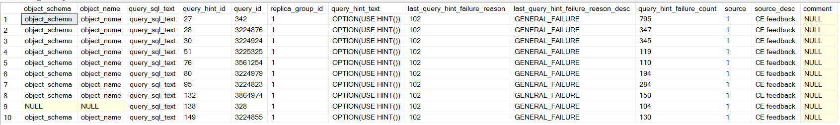

  3. Henrik Johansen 35 Reputation points
    2024-01-22T05:48:01.98+00:00
    I have been running CU11 for 8 days now without the error, so I think it is safe to conclude that CU11 DOES fix the problem. I used to get the error ~5 times/week. Remember to purge the query data after enabling the query store!
  4. Erland Sommarskog 129.4K Reputation points MVP Volunteer Moderator
    2024-01-12T17:42:34.16+00:00
    SQL Server 2022 CU11 was released today. In the fix list I noticed this https://learn.microsoft.com/en-us/troubleshoot/sql/releases/sqlserver-2022/cumulativeupdate11#2787964:
    Fixes an issue in which the Cardinality Estimation (CE) feedback generates an empty USE HINT clause as the query hint.
    Since I have not run into this myself, I cannot vouch for anything, but it absolutely sounds like some that could result in this mysterious syntax errors.
