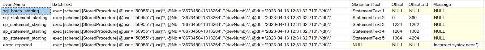

Sometimes when connecting the application via mssql-jdbc-9.4.1.jre8 errors "incorrect syntax ')'" appear, although the prepared query and procedure definition are correct.
Errors appear randomly. Stored Procedures can execute correctly several dozen times, and that an error appears in 2 or 3 subsequent executions. After that, the procedure works fine again (object definition hasn't changed)
The problem occurs on various procedures, but has never occurred with database compatibility_level=150.
Any ideas what could be causing the problems ?

Error caught by XE
StatementText5

    Had you used the view in my article, you would have seen the statement where the error occurs. Although, the sql_handle is all zeroes here. But list_exceptions_sp will give you the full call stack.
    But, hm, maybe this is related to PSP optimization where they dispatch a new query if a query is deemed to be subject to parameter-sniffing issues? To understand this, you would need to analyse the plan cache. But since you don't seem to disclose the code in public, my recommendation is that you open a case with CSS instead.

    A few ideas to narrow down the problem., both for Greg and Chris. Can you try:
    ALTER DATABASE SCOPED CONFIGURATION SET PARAMETER_SENSITIVE_PLAN_OPTIMIZATION = OFF
    in one of your databases where you have this problem, and see if you still get the the error? This would determine whether PSP optimisation is involved or not.
    Also, can you use list_exceptions_sp and look at the statements on the call stack? It seems that the top frame has an empty SQL handle, but I'm curious on the one below. the sql_text element in the XML event is not of interesting when this a stored procedure call.
    Can you see a common pattern? To add a leading question: is the last character always a right parentheses?
    And for that matter, is the error message always exactly that: Incorrect syntax near ')'?
  3. Greg 45 Reputation points
    2023-06-13T12:40:45.48+00:00
    Unfortunately, after disabling PSPO Incorrect syntax near ')', errors still appear.
