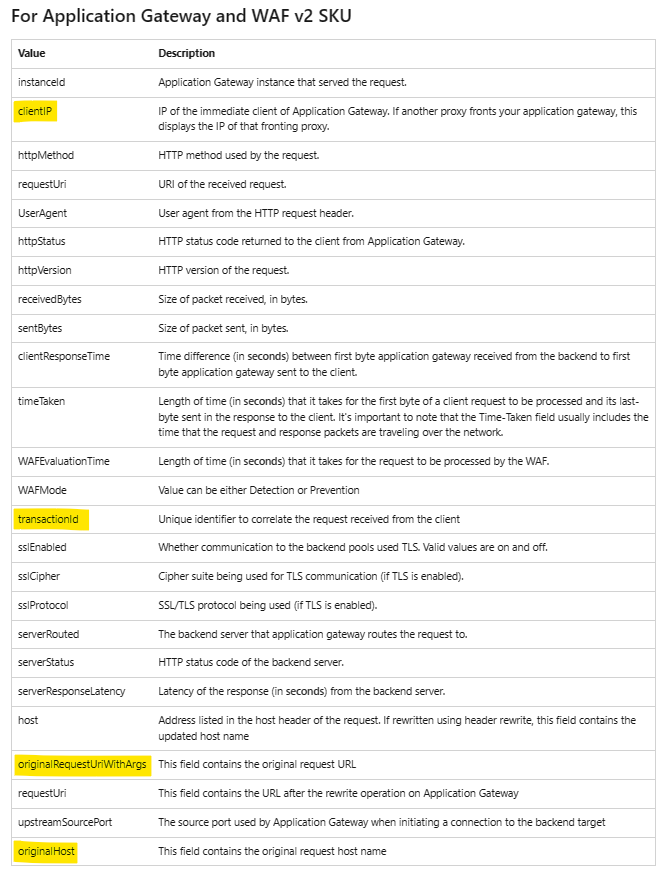

    Below is a screenshot of the packet trace collected on the backend VM server behind Application gateway and you can see all the 6 headers listed:
    enter image description here
    If you want to find these headers from the Application gateway logs, I'm afraid they are not listed directly as headers but have different names and you can find them in Application gateway Access logs as below:
    • x-forwarded-for --> clientIP - IP of the immediate client of Application Gateway. If another proxy fronts your application gateway, this displays the IP of that fronting proxy + the clientPort value from the logs.
    • x-original-host --> originalHost - This field contains the original request host name.
    • x-original-url --> originalRequestUriWithArgs - This field contains the original request URL.
    • x-appgw-trace-id --> transactionId - Unique identifier to correlate the request received from the client.
    Refer: https://learn.microsoft.com/en-us/Azure/application-gateway/application-gateway-diagnostics#access-log
    x-forwarded-proto and x-forwarded-port values are not available in the access logs but should be easy to find as it depends on the request and there are only a couple of options as below:
    • The valid values for x-forwarded-proto are HTTP or HTTPS.
    • X-forwarded-port specifies the port where the request reached the application gateway. For HTTP, it is 80 and for HTTP, it is 443.
    Refer: https://learn.microsoft.com/en-us/azure/application-gateway/how-application-gateway-works#modifications-to-the-request
