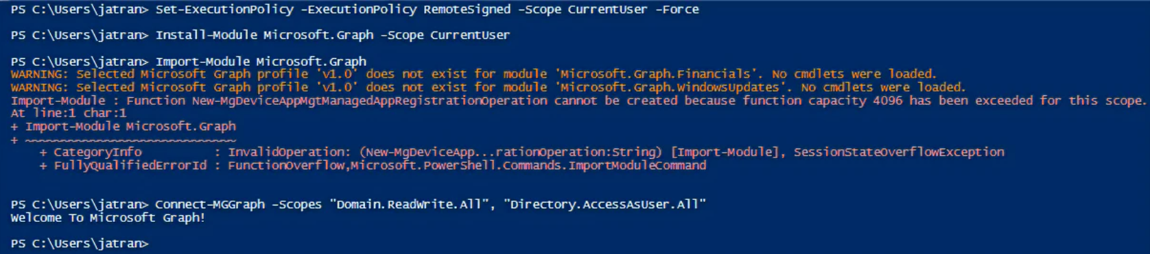

    • Connect-MgGraph: Device code terminal timed-out after 120 seconds. Please try again.User's image
    I understand that you're trying to Configure federation between Google Workspace and Azure AD but when running the PowerShell script located in the Configure Azure AD as a Service Provider section, you're running into the above error message when using Azure Cloud Shell.
    Findings:
    When working through the documentation within my environment, I also ran into this error when using Azure Cloud Shell. However, after reading through both documents that you shared, I noticed that they mentioned using PowerShell / a PowerShell session.
    After installing Azure PowerShell, I was able to install/import the Microsoft.Graph module as referenced in the PS script, and login when prompted to authenticate to Azure AD, using the credentials of my Global Admin account.
